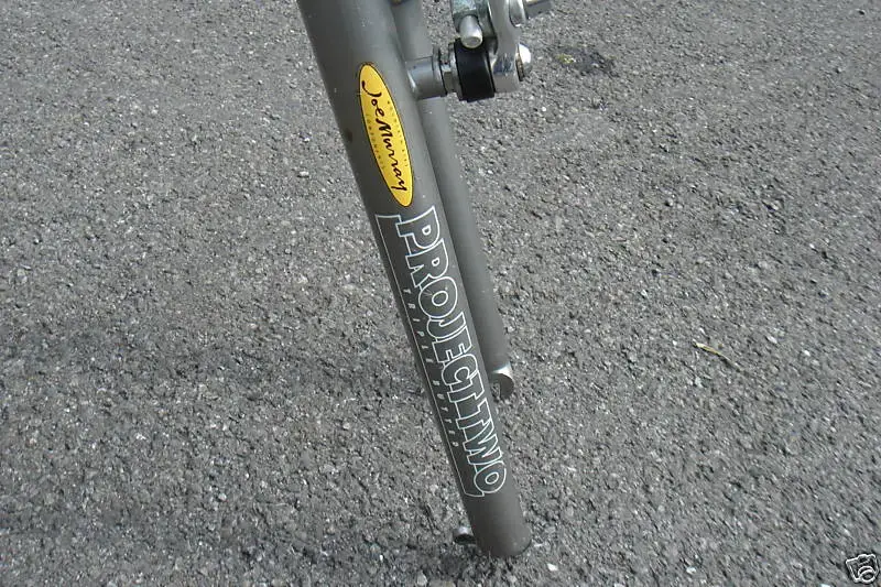

Based on my experience, I would wait and try the 27.2. I'd guess it'll either be just right or slightly too tight, depending on how much reaming that particular tube needed.
You do see 93 P2s on eBay, they're not that rare - and of course as well as the geometry advantage, they're silver to go with the silver front ends of the European 93 range. But yes a RC36 on 70mm setting would be nice also.

The frame has arrived! my second steel steed 16 years after....
I have goods shipped to my work address where I have 24/7 goods receipt. The headtube is 130mm confirmed, no tools to check the seat tube, that'll have to wait until this evening. What strikes me is how light it is, and how thin the head tube is. Also it does look rather small but I guess that is the thin tubes effect. About those tubes, now I understand the fluted downtube/ bulged seat tube comments, it is an Explosif.
At first inspection it looks in fine fettle, with good details. I must have a closer look inside the seat tube, but it looks OK. I think I'll build it with what I have to go riding and then work out a plan for a respray and dedicated build this winter.
Enjoy!!
Final update, the 27.2 post does go in, it's fairly tight but it moves. Luckily this is the frame with the most seatpost extending.
