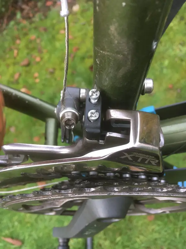

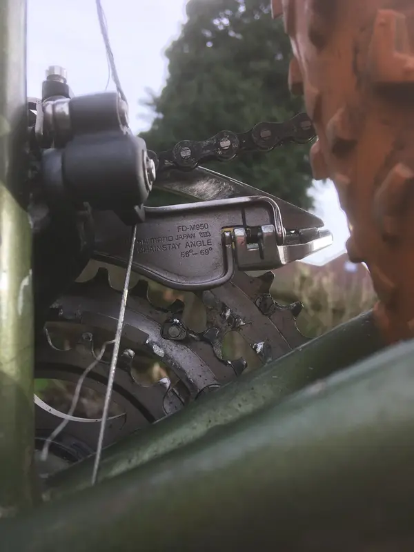

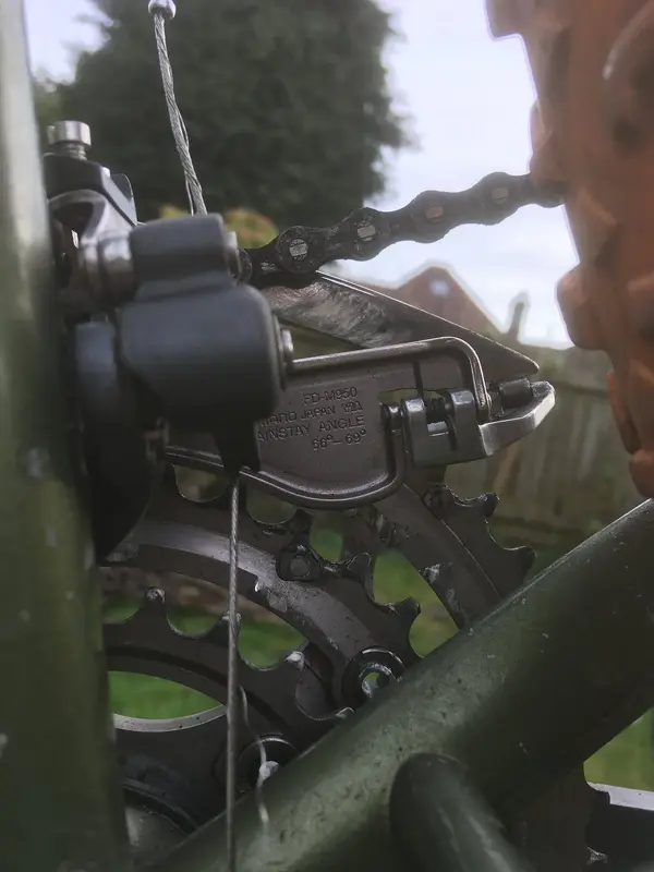

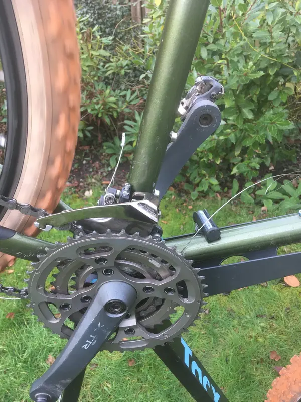

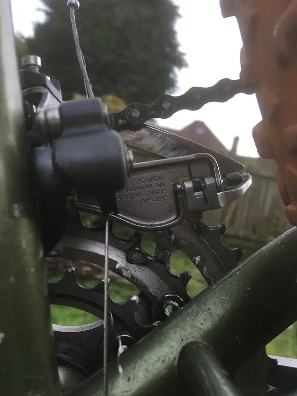

ishaw thanks for your reply , yes it definitely is a bottom pull version , when I set it up and initially click into the higher gears it works fine at this point the cable has come away from the guide in the mech which is just a narrow channel . the problem arises when I click down the gears and the cable doesn't locate back in the groove . On inspection the cable doesn't seem aligned between the mech and the bb cable guide thus making me wander if different options in cable guide are available .
so here are some photos of the issue , the first two show the cable not quite locating in the guide when clicking down the gears, the third is on the way up correctly seated in the guide as does photo 4 from the other side
