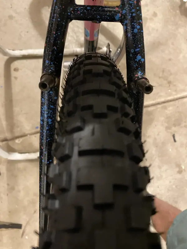

I recently started building up a 1990 Explosif. I purchased some XT cantilevers to put on there. I can’t fit them in the back. The posts are way to big. Posting pictures below of my break bosses, am I missing something?

Yeah, I really don't want to screw this up again. So the brake bosses are in different areas of the frame for cantilever and u-brake, right?
Yes. U brake pivot point is different and a different size.
U brake pivot is above the brake blocks......cantilevers pivot below the brake blocks.....as seen in your picture.
