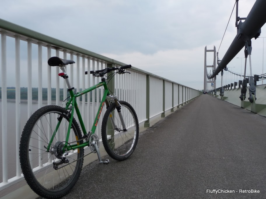

Fluffychicken on here has a repainted 97 explosif and his has the same canti stop at the rear as the one with the ghastly respray, not saying it is definitely an explosif, but i wouldnt rule it out due to that, tis bloody awful though ans its an 18" too!

Found a picture to show this...
http://lh3.ggpht.com/_eehaXRpEJXU/S-L2H ... 020650.JPG

Yeah cheers for the picture – I did do a search for Fluffychicken’s ’97 Explosif, as it hadn’t occurred to me that the frame on e-Bay may have been modified before the “ re-spray”.
The Seller is claiming it to be an Explosif, but there seems to be too many features from various years - with or without modifications!
The Dropouts with a triangular hole and Rack Mounts feature on the ’92 & ‘93 Explosif, and the ’92 also had the brazed on upper Rack Mounts like the e-Bay frame. Those style Dropouts had gone by ’94 though.
As I previously mentioned, all 3 cable Top Tube routing would indicate ’98 onwards, but then the dropouts are very wrong for that – unless of course the cable stops were also an addition like the Canti Brace before spraying.
I’ll carry on searching to see if I can find a Steel Kona that matches the e-Bay bike that has decals based on a 1997 Explosif.
