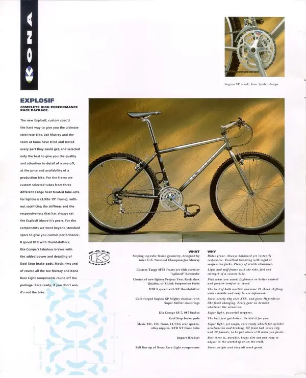

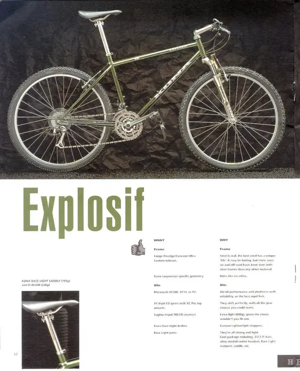

The tubing was the same in 93 & 94. 94 was dark green, 93 was a silver front faded into a midnight blue rear end.
The project two's are from a 94 model. 93's weren't suspension corrected and had different decals.
iveto- I have the US 93 Kona catalogue, spec may have been different in the UK version.
the Explosif was spec'd with a suspension (Tange Struts in the pic) but they hadn't changed the frame/fork geometry yet so you had to adjust via stem rise and tyre size if you changed forks
The two attached pictures show a 94 catalog Explosif and a 93 catalog Explosif. Note the different fork options and suspension corrected geometry in the 94 catalog.
