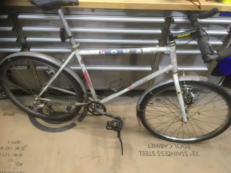

Later it became a single speed with a locked out rear mech and 1 x chainset as pictured above.

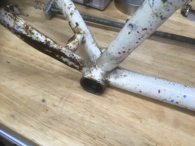

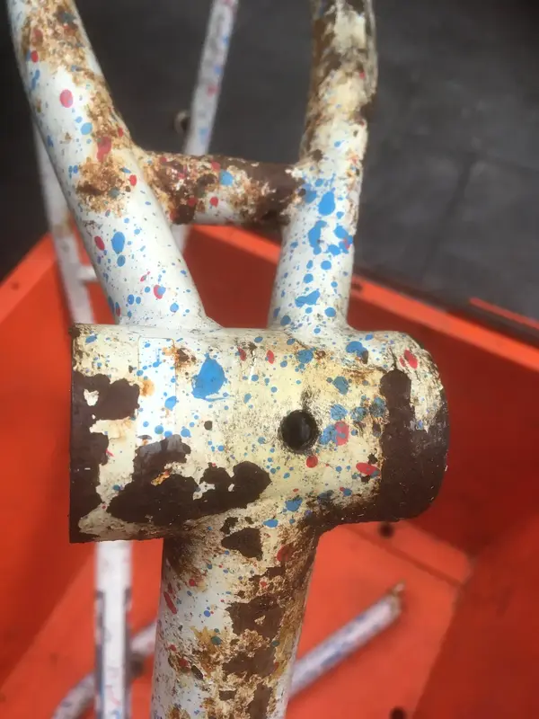

Through last summer lockdown it nearly got binned altogether having lost/binned/given away all the components…..but I held onto the frame/forks/stem and bars for posterity if nothing else. By now the frame was is a poor state, very rusty around the BB area. The BB was seized and the lh crank had to be cut off as the internal thread was stripped.

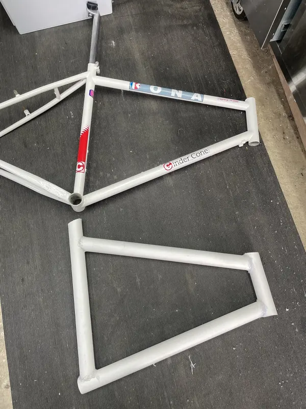

So, I found a local blasting/painting firm who repainted the frame to a bare white and the stem/bars to black for a whole £60.

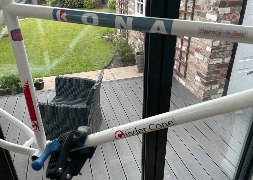

I got hold of set of decals from Retrodecals (excellent) and so the rebuild starts……..

So far just done the decals and polished a seat post and dabbled with splatter painting on an old plastic pipe - planning on making it red and green inplace of red and blue.......so to match the Italian flag colours.

Umm.......not sure about leaving all white, will look at the spatter techniques

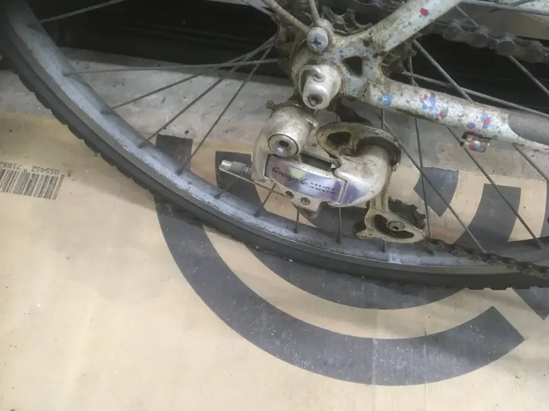

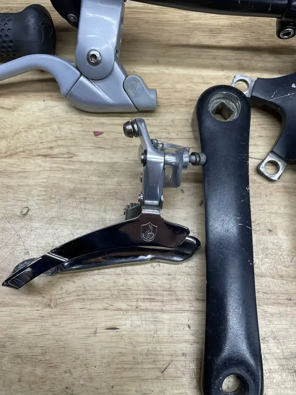

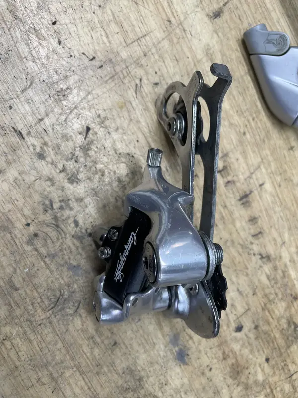

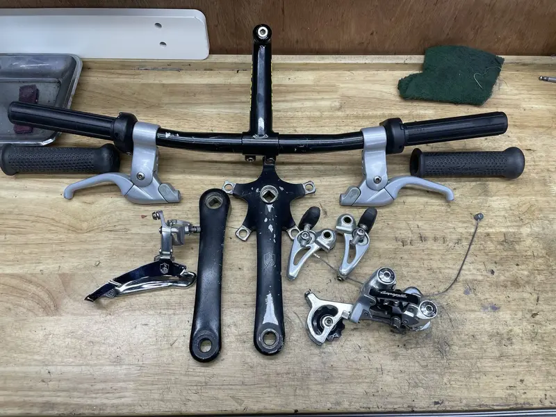

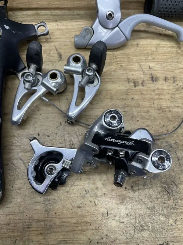

Some parts, so far.......all very heavy, esp the rear mech! The cage side plates are so thick, some drillium needed:LOL:

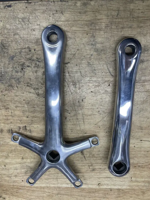

The chainset is the graphite version, but needs fettling, may strip and polish, as I've done with an old Record chainset, which had 5 years on the turbo and had become very pitted - a good few hours with some files, a wet/dry paper and a buffing wheel, looks good now. Just need the decals.
The front mech is a campag 28.5 band-on, may need a bit of work to get it to fit the Kona down tube which is a touch bigger, maybe the paint?

I always wondered how those Campy gripshifters work. I remember seeing them in the early 90's on Kleins. They are definitely the coolest looking gripshifters, being they are not a halfgrip. Do they ever shift by accident?
I have yet to find out how they shift in use. Hard enough getting them off the original bars.
Remove rubber grip, then long allen key into the end and try and undo the expander bolt, one can off, one snapped the ball end of the allan key (only 4 mm). then undo the more obvious clamp bolts
Took one apart to see how it worked - fiddly to get back together, springs and positions to figure out😬
Yep, you pull to much- it shifts. Bunnyhops only possible if you intentionally shifted to the end stops. Later ones had a wing nut where you could dial in the friction, but imho they were still just suitable for "touring". BITD I "upgraded" from XT 730 to Centaur/Bullitts. Took all of 5 mins to figure out that I should have bought XT 732/Hyperglide😖. Much later (2005?) I bought some Campy thumb shifters, still bad performance. Campy outer cables just fold like an accordion and for even marginally precise shifts you need the OEM (and now very rare and $$$) Rohloff chain. But oh so beautiful ...

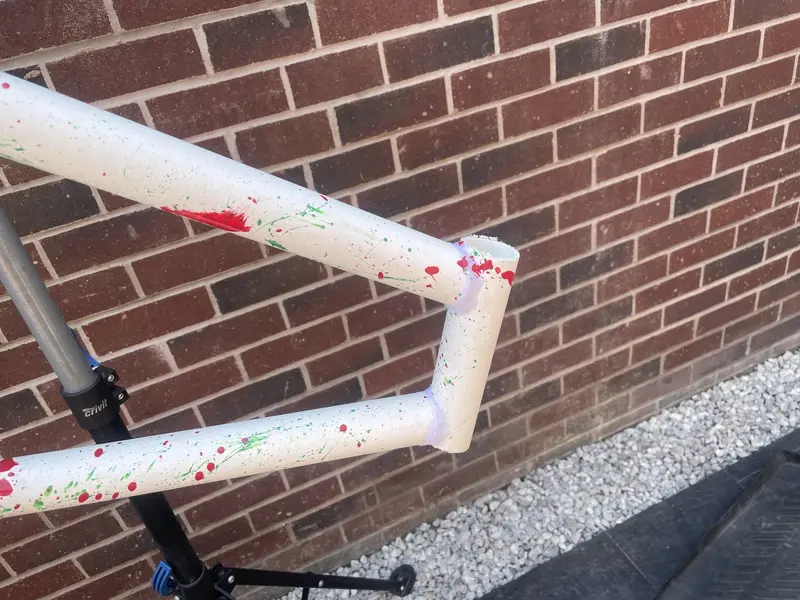

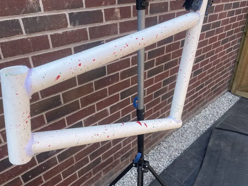

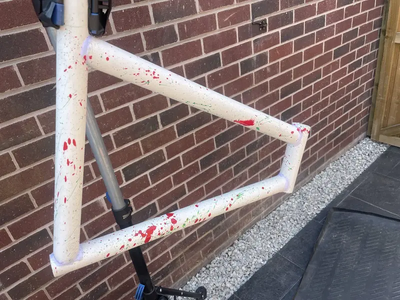

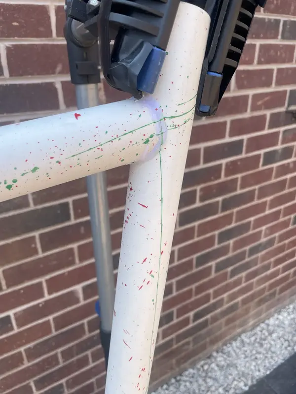

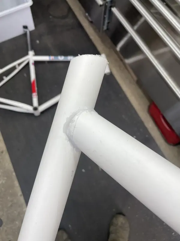

So, had a go with the splatter paint, using some Tamiya model making acrylics, but first I knocked together a dummy frame using sold old plastic waste pipe and a glue gun, roughly cut mitre and lots of glue, but it's quite sturdy :)
Then just had a go with couple of brushes, got more paint on the backing sheet than the frame and go too close with the brush. Initial green was too thin and ran a bit, so just went with paint straight from the pot, no thinners.
Reasonably happy with test piece........ only get one shot and the real thing.....maybe tomorrow 😧
