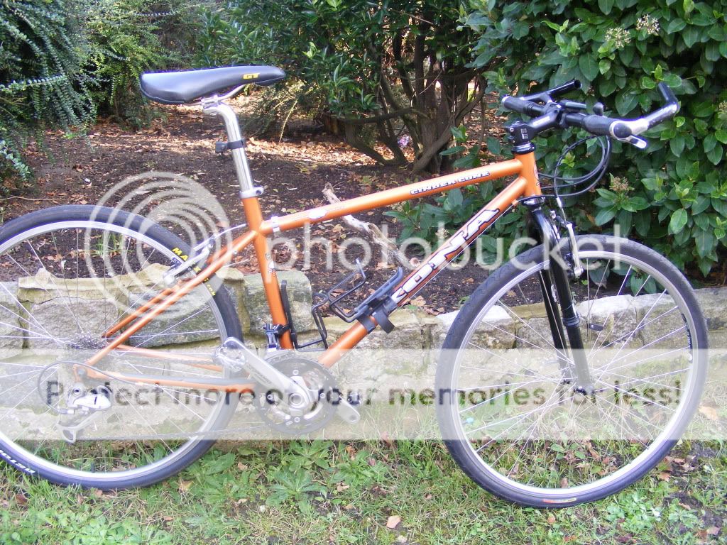

You have inspired me. Thank you. My '94 Cindercone I have owned since new. But except for the shifters, frame, seatpost nil else is original.
After seeing yours I think I will put some off road tyres back on.

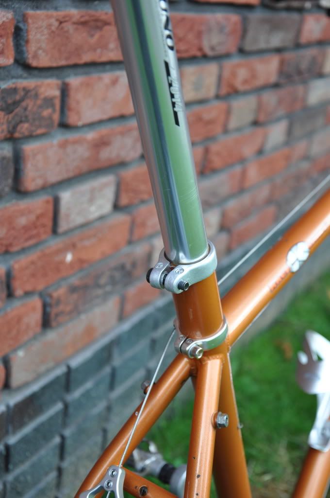

Thanks to some good advice from my LBS (cycleparts, nijmegen) I got the seatpost out ... basically was not trying hard enough. I used my neighbours bench vice this afternoon, with a bit of effort, a lot of noise (really terrible screeching sound as we rotated the frame), the seatpost was out! :-)
Seatpost was trashed from being held in the vice, but not to matter, it was not original anyway ... on removal I could see that it was a Kalloy unit ...
Now, all I need is a nice shiny Race Light seatpost in it's place. Anyone have one for sale? (will place a post in the appropriate area of the forum).
From what I've read I need a 26.6 size unit. The Kalloy was also that size, but maybe too long? After cleaning it it moved fine in the frame but I could not get the seat post in much further than just below the top tube. When fitted the tube was jammed in well below the top tube. I don't know how far the post is supposed to descend in to the frame. Anyone out there with some advice on this?

thanks for the tips. I'm pretty sure it's a 26.6, the kalloy post that just came out says 26.6 on it (I think, underneath all the scratches and corrosion). Will take it in to work tomorrow and measure it to be sure. The 26.6 post did seem too big for the frame (will not fit below the top tube). Guess it could be the variation you mentioned. I may take a punt on the 26.4 post

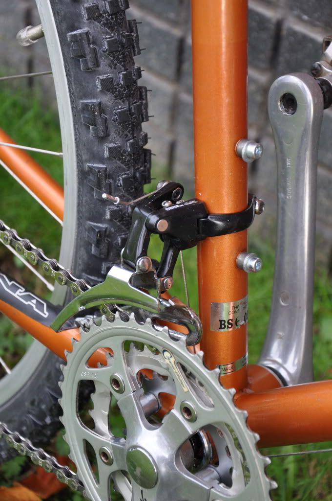

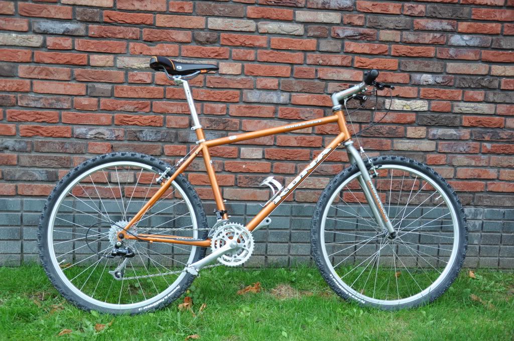

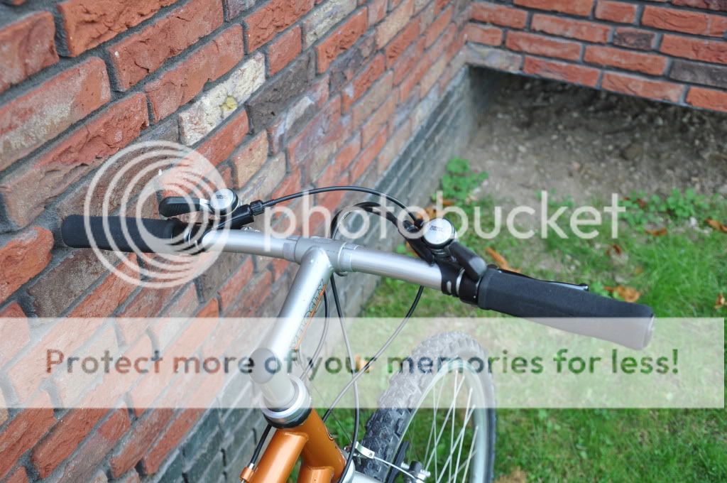

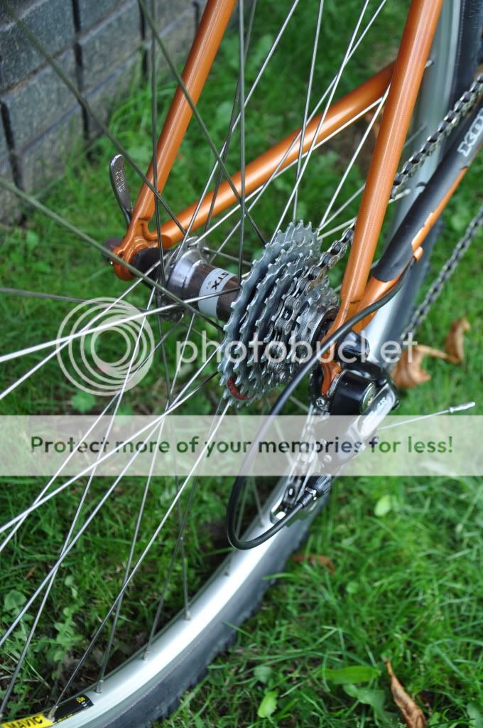

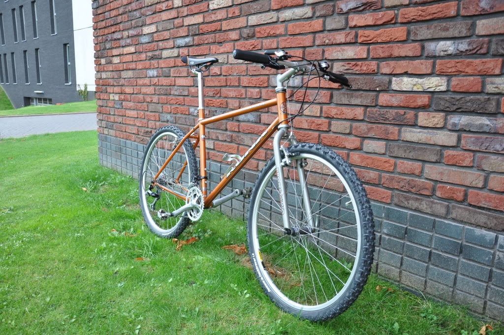

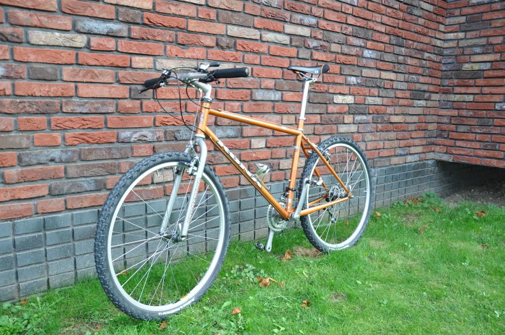

finally finished!
Finally finished the rebuild. Took much longer than I initially expected, but very pleased with the result.
Lost some time trying to fix up the original wheels that were not worth saving. In the end got some nice wheels from raidan73, very pleased with the result.
Lots of time waiting for the 26.6 seat post to be posted from the US (first class post takes weeks!)
Happy with the Crank Brothers saddle with matching orange trim - was a bit indulgent, but had to buy it when I saw it.
Some photo's now, before I take it to get muddy over the weekend. Specs to follow later.
Will ride it for a year or so, but already thinking that a respray would also be nice ... maybe some STX cantis as well ...
Hope you all like it :-)
Very nice job. It could not have seen much use if it still had the original A/drive B/drive tires. I still have my original grey A/drive in a box but the B/drive wore out many years ago. You've given me a bit of inspiration to give my 94 Kula a strip and rebuild now.
