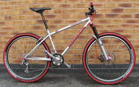

It doesn't appear to have adversely affected the handling and I run the fork pretty soft so with the sag it feels bang on - Still a nice and quick front end. Fork is around 1600g as well so that helps.
You don't need to run the fork soft for the geometry's sake - if the stem is about 70-80mm then your set up is fine anyway. A 100mm fork with 70-80mm stem will give similar handling to a 60mm fork with 110-120mm stem (such as the frame may originally have been designed for).
I personally would have preferred it with correct 1996 decals from Gil_M, which would have actually saved you money compared to those eBay ones, but I suppose the red colour does give it a certain 'fun bike' persona which may suit its purpose in life.
Re style
Thanks for your kind words but things have changed a little since I made this post. A bit of fine tuning and restyling has resulted in this....
Did the Marin trail on it on Saturday and it rode like a dream! :twisted:
