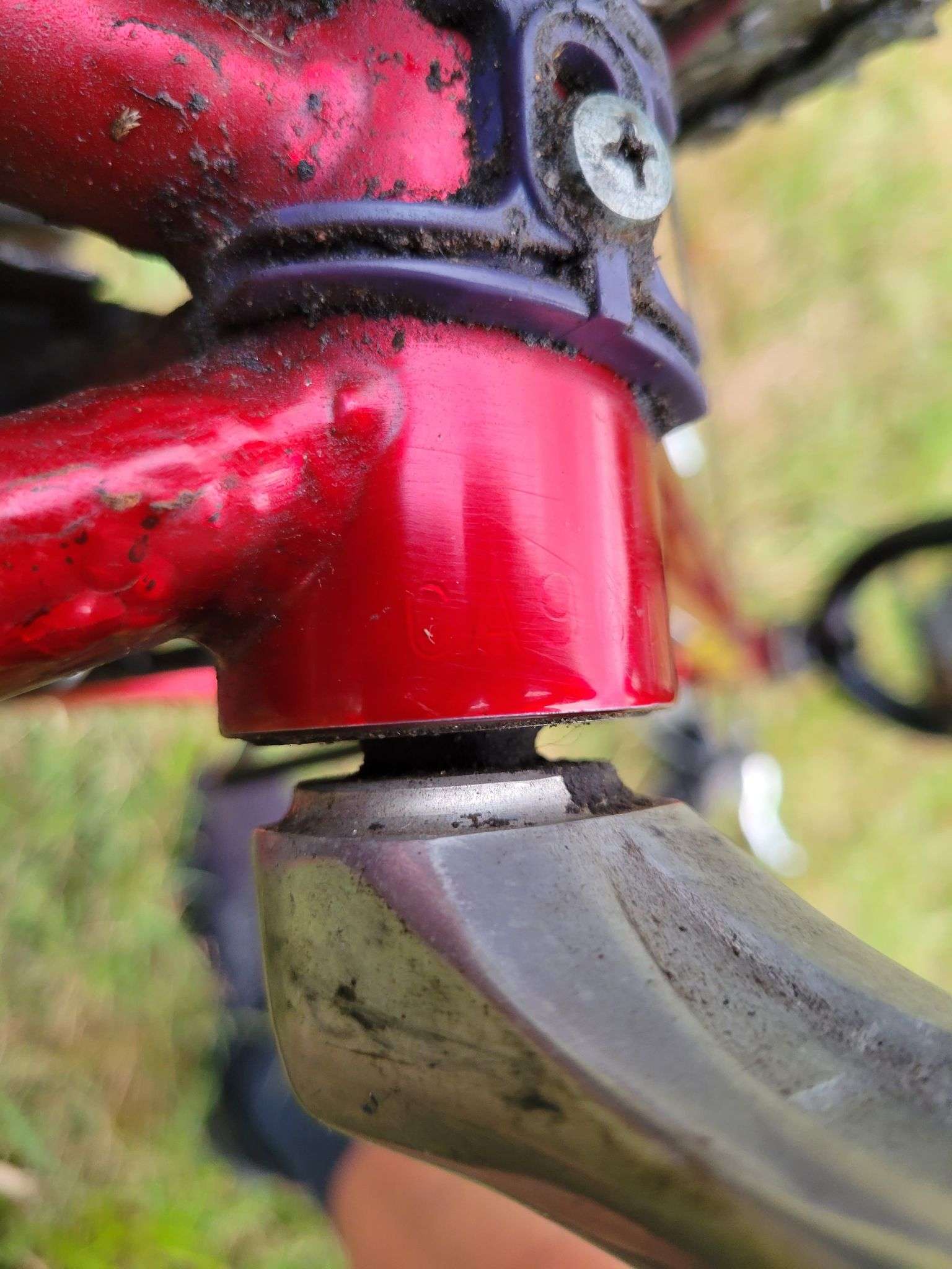

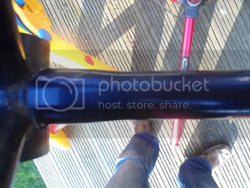

Yes you are correct regarding the tubing that was used for the confirmed seven Caldera frames that we have seen so far. What we see, is a variance in the Bulge of the Seat Tube at the Bottom Bracket Junction in these frames. Needless to say, they are likely to be left over Mountain Goat stock, and renamed after Jeff's MG Company folder in 1995.
Anyway...... elmadu: CA9609021, Molotov Red 16”, and your CA9609046, Poopsy Blue, 20" have no Bulge:
While konaman1: K09610031, Poopsy Blue, 18" does have a Bulge - Prefix notwithstanding to account for anything 🤪 !

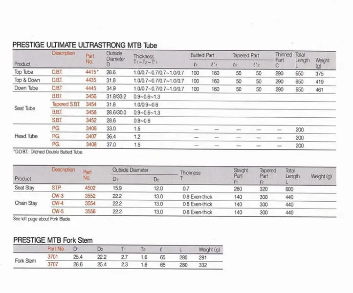

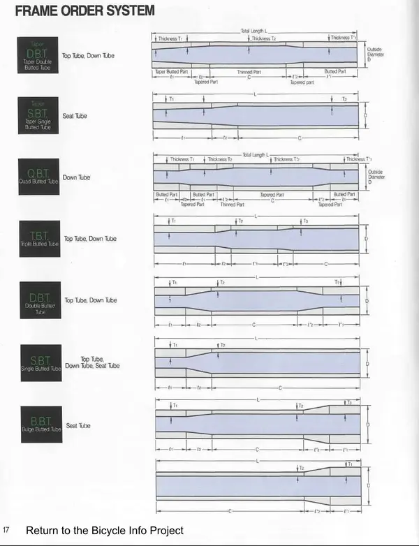

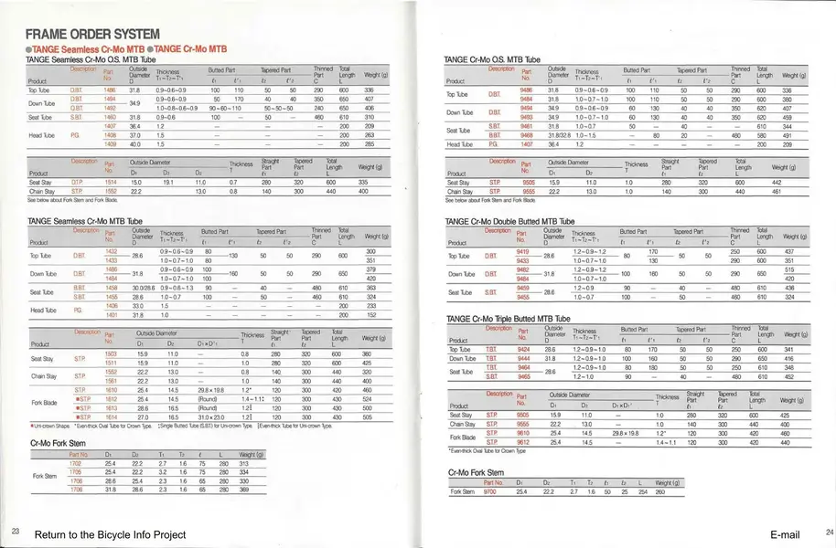

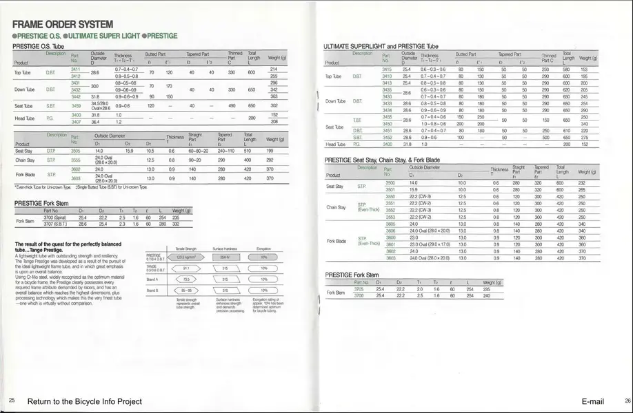

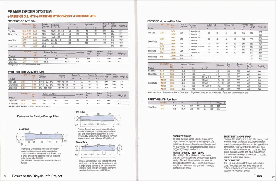

I can add some pages from the Tange Catalogue to see if that helps with identifying any tubing - I should get the whole catalogue added to Archive.

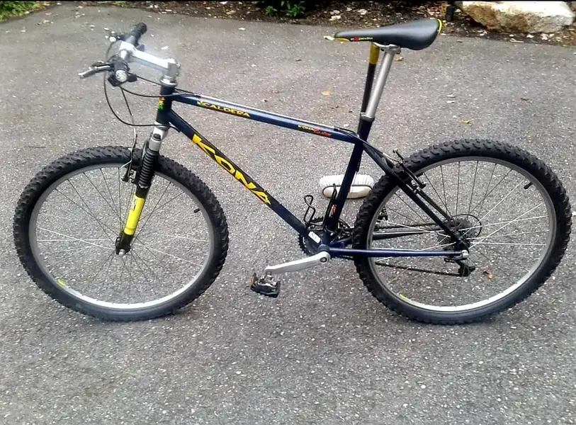

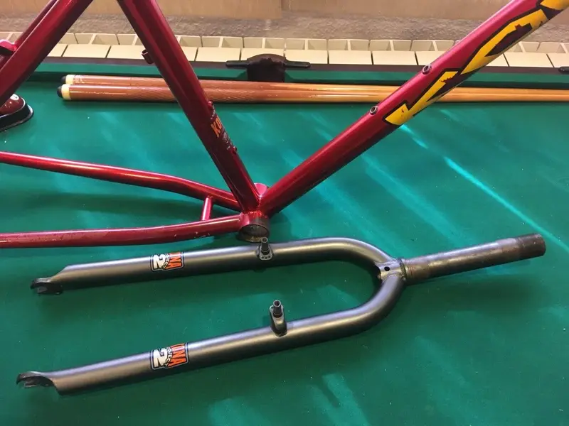

Here's one I picked up off of FB Market Place few months back. Knew it was kinda rare... However, here is the kicker. SN CA9609158. Size 18.

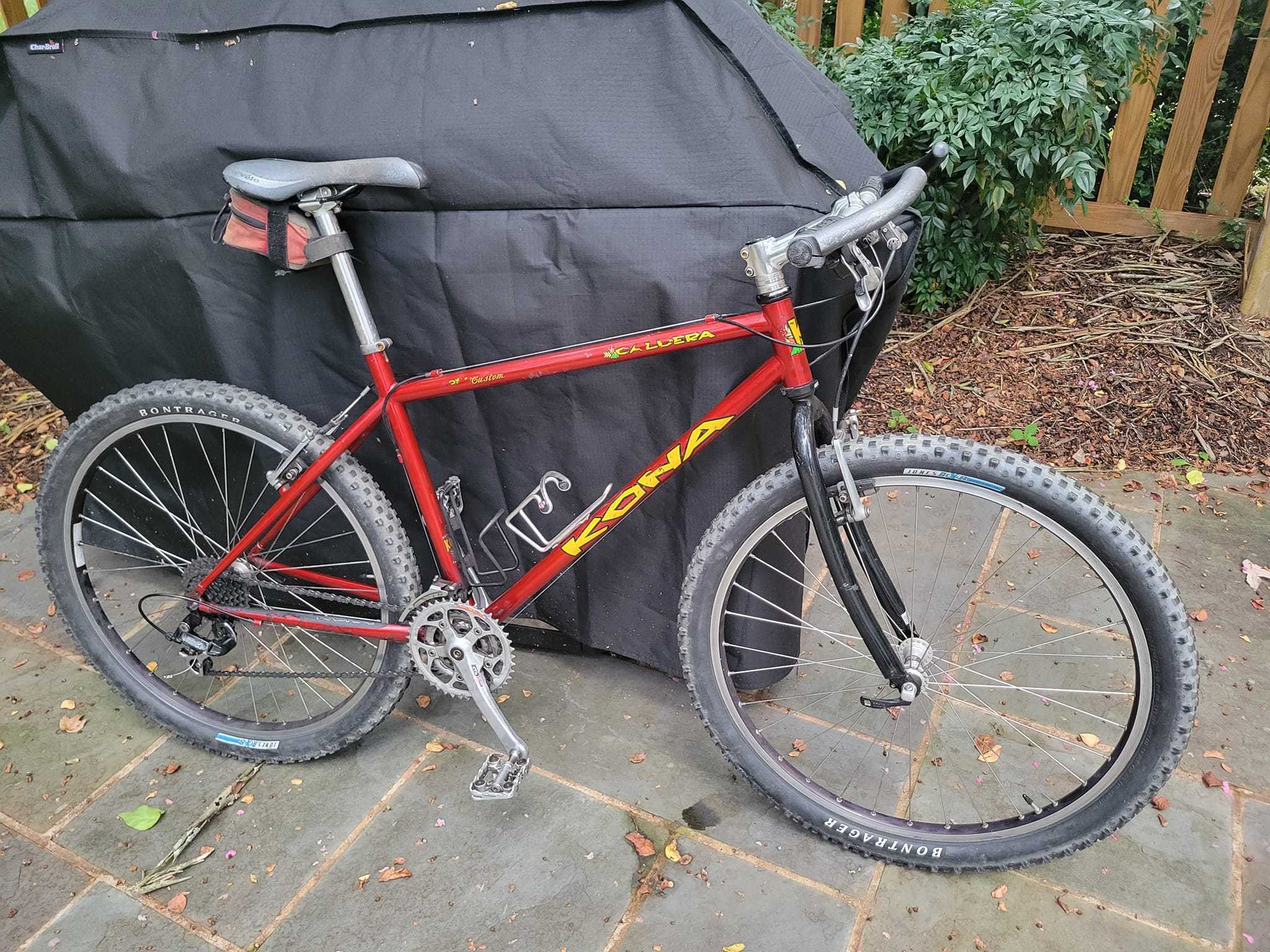

Wind up the klaxon, we've reached double figures! Thanks to Maxwellllll we now know of 10 1997 Calderas and crucially, to date, he's the first "owned from original" example. Even better, it's in the gorgeous Molotov Red.
CA 9609109 Molotov Red, 19" (maxwellllll)
caldera-2-jpg.732444
caldera-serial-png.732438
Number 109 puts it firmly in the middle of the total production run, which we now know was larger than the originally stated 50 blue, 50 red.
