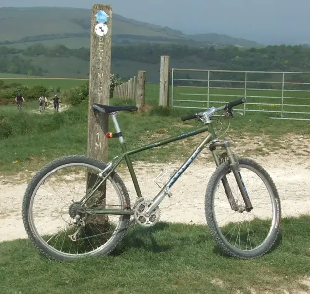

I won't repeat what I said in the other thread you found, but I'll show you two bikes, a size 18 and a size 16, which are near identically the same size and have nearly the same handling. The size 18 has a 2cm longer fork, a 2cm shorter stem and a 2.5cm longer top tube. i.e., in devising your personal design, you could start with the length of fork you wanted, that determines the length of stem and that determines the top tube and thus the frame size. I haven't myself tried a size 19 Kona with a 120mm fork and a 60mm stem, but I don't see why it shouldn't be a good bike - and effectively the same size as a retro size 16.
