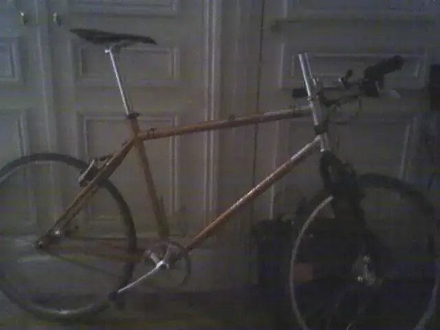

I think you could probably go either way. I'm 6'1" and I ride a 20" '94 Kilauea with plenty of seatpost showing (about 74cm bottom bracket to saddle rail, from memory) and a 110mm stem. It fits me fine, but I've been thinking about trying a 19".
I can take a few measurements of mine if you like.
Here you go.
BB to seat rail: 74cm
BB to saddle top: 78cm
Front axle to top of headset: 59cm
Seat post visible (to rail): 22.5cm
Actual top tube length c-c: 58.5cm
The stem's a 110mm Thomson Elite with a little rise, flipped to give a little drop, with a 5mm spacer underneath. That puts the bars about 10cm below the top of the saddle.
That should give you an idea. If you like your bars lower, you'll need the 19". Drop me a PM if you want any other measurements.
