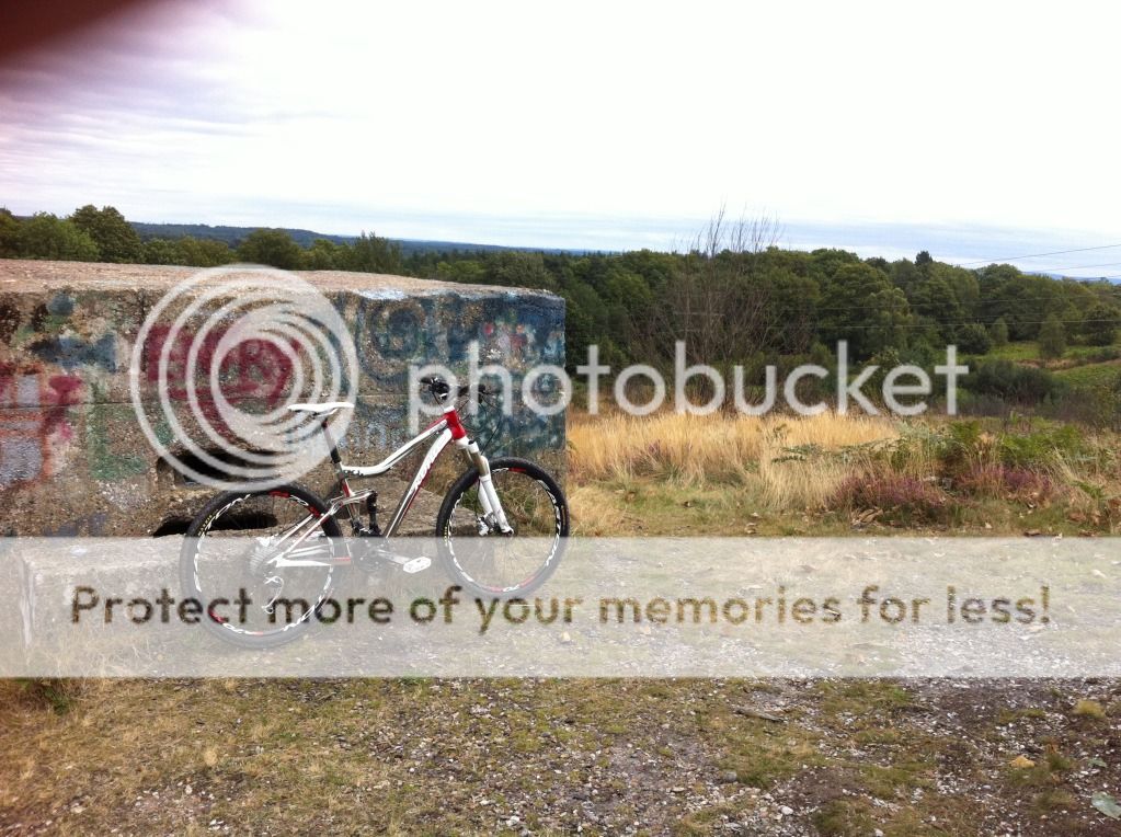

I took this from the top of a steep and loose climb that I always struggle with on the rigid. Even with the Maxxis Aspens which look pretty slick it despatched the hill with ease and without me collapsing at the top. :lol:
Mandatory bunker shot. Yes that's my thumb :oops: I'm no David Bailey.
all in all I'm super pleased :D

Really nice bike. I'm looking into a full suspension XC as well, but for street use (you don't want to know how bad the roads here are).
Twas a massive bargain from Crc. 50% off!

Looks pretty tidy and a cracking bargain too.
