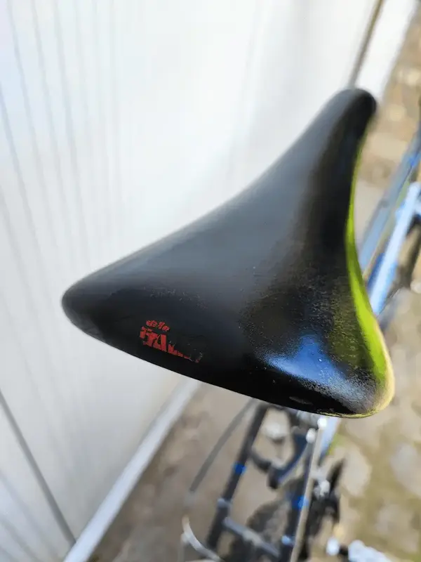

I put a new (to me) saddle and temporary seatpost. The seatpost was free, as I bought quite a few parts from a local seller.
It will have to go, I think black does not work with the frame colour, and it's too short, I'd like it to go higher.
The stem will also have to go, it's ugly.
The saddle (Flite Titanium) is showing its age, but I don't know how to preserve it.

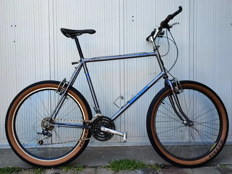

I received new tyres for the bike today. I haven't finished installing them tonight, so I'll share pictures tomorrow.
I opted for the cheapest tyres on the list, which are priced at 21€: "Maxxis Ikon EXO Protection - 3C Maxx Speed - Tubeless Ready".
Once they were on the bike, I noticed that the sides appear darker than they did on the website. I suppose I got what I paid for.
By the way, while changing the tyres, I discovered that the two rims are not the same. Does anyone happen to know what the correct wheels/rims were when the bike was new?
I don't have any pictures yet because my usual picture-taking spot was unavailable.
I think the tyres look really cool on the bike.
Earlier, one of my sons told me that the bike looks like it's from "Stranger Things", which in my language can be translated as "vintage" or "retro."
to compare to:
Lots of things have changed, some others will have to go to later on.

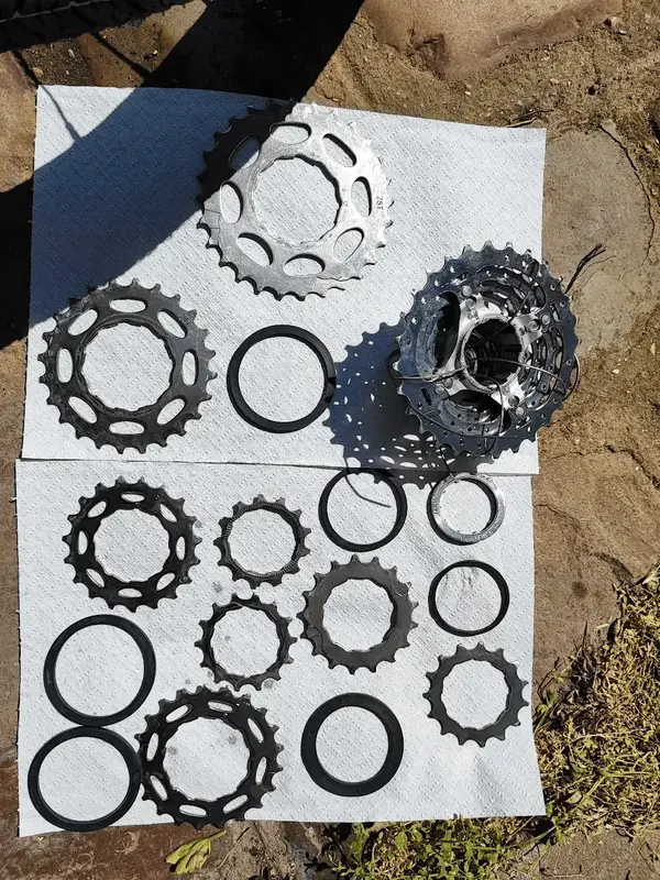

A new (to me) crankset (XT) is expected to arrive this week. However, I made (yes, another) a mistake and also purchased a new (to me) XT cassette, which unfortunately doesn't fit on the existing hub. The hub is significantly larger than expected.
I suppose I'll need to purchase the appropriate XT hub and build a wheel at a later time.

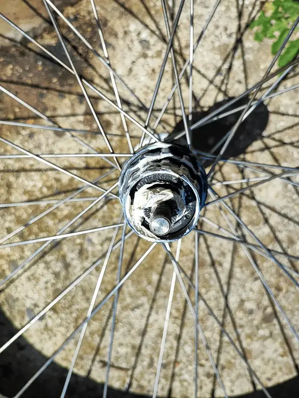

Before doing so, I'll have to service the current oversized hub, as it's making unpleasant sounds of grit and humidity instead of smooth grease and steel balls.
However, I'm unsure which tool I should use for this task. Please forgive the excessive amount of grease; it was a desperate attempt to provide some lubrication for the hidden steel balls until I can find the proper tools and procedure to service the hub.
