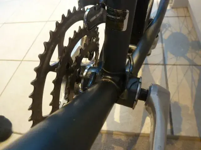

The replacement BB axle for the 70mm shell turned up after a long delay in the post. It did the job of allowing the lock ring to fit on to the adjustable BB cup. It's a cheap Oxford branded one and doesn't feel that smooth fitted. Not sure if use will fix that. Never mind, it allows the build to progress and can be replaced later if needed.
A lock ring, locking

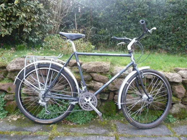

Bits and bobs of progress over the last few weeks:
26.8 mm Shimano seatpost from SJSC plus a Brooks saddle that I've had a while.

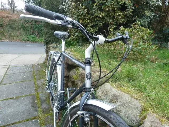

Some wide black steel handlebars with a nice pull back and rise, making for a comfy upright ride. A Strong stem, currently white but likely to be either stripped to bare alloy or painted black if it’s the right shape (first impression - it is).
SKS guards from Planet X from when they were about £7 and a second hand but unused Tubus rack on the rear.
A new SRAM chain and 7 speed cassette, plus some new grips.
Continental Travel Contact tyres
Lots more to do: trueing the wheels, cutting the mudguard stays, adding the front rack, trimming the cables, painting or sanding the stem. And then… looking at trying a Nitto dirt drop stem and drop bars with bar end shifters as an alternative bar/stem combination.
