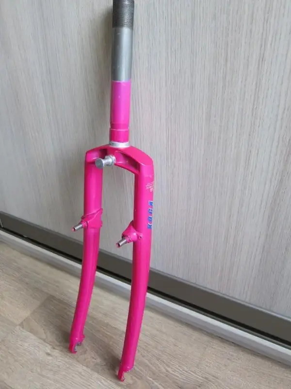

I got my hands on a Koga Miyata Fatmax II for my Miyata, which I think is a APA-bonded alu fork. Unfortunately it was the wrong color. Searched for a long time in my area to find someone who could wet-paint the fork - as most only could do powder coat. But when i got it back they had powder coated it, despite my clear instructions. Now I am afraid that the bonding has suffered damage from the heat of the powder coat process - Should I be worried? It seems as it was before - but I haven't tested riding it.
Attached is a picture of the fork before painting.

I really don't know what influence the temperature had on the glue. What temperature is used for the procedure?
I can ask him - but from a quick search it seems that the temperature range is normally from 160 to 215 c.
Yes, it is the one you helped me with. Finally had the funds to get it painted, and thought i had found a good place to do it - so annoyed that he did not listen when i told him not to powder coat it...
