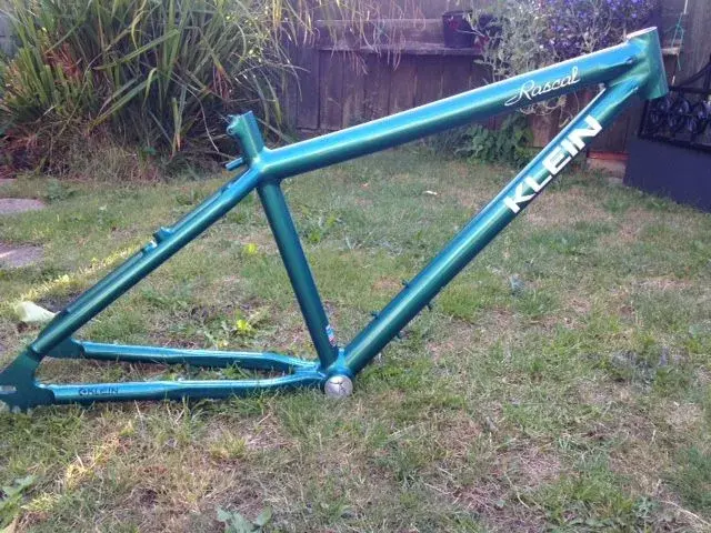

integerspin":gxo5t4nc said:
What's debossed mean?
It means that lettering is impressed on surface. He painted with white color, than applied decals and than painted the frame with green color. After that he removed decals and was left with white colored lettering.

mkaavin":331c6bng said:
Impressive that you also painted it with debossed decals.
haaa! cheers!
not this one!
debossed means the decals dont stand proud because you use a mask on the base coat, then put the top coat on wait for it to dry then remove the mask leaving the inprinted letters , so theres no actual decal to rub off . much more classy. klein are renouned for it!
hope this clears it up.
also look at the pics :D

this is as far as ive got at the mo. i need to find some forks then i can get on with the build!

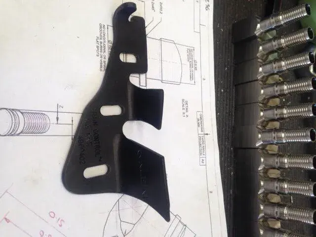

After a good polish up i ve now recieved the chainsuck device back from the anodisers, and looking like new again :D
I really like the work you are doing in restoring this little Rascal
Impressive paint job and an exquisite attention to detail :shock:
This build promises to be very interesting and I will follow this post with much attention .
