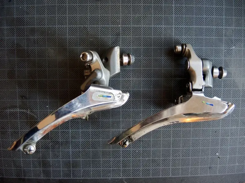

Have you managed to dial the claris levers in using the 600 front derailleur?
They do seem to have a slightly shorter throw then the 600 brifters, so i just cant seem to dial them in so i have the entire range without rubbing.
I might just buy a claris fd-r2000, as they are quite cheap and should in theory work with the 53 tooth 600 crank.
No issues here with the Claris and 600 front mech - the trim positions sort the rubbing (on the big ring there is a trim to avoid chain rub in the bigger sprockets, and in the inner ring there is a trim - if you gently move the lever 1-click - that avoids run in the smaller sprockets).
yeah, i know about the trim, but no matter how i set it up i seem to get some rubbing with either the highest or lowest gear combination, since it doesn't seem to pull enough wire to clear the entire range with good margin.
right now i have it set up so that the highest gear rubs, as i seldom use the 53/12 gearing, but i would like to have all gears rub-free.
i do have another 600 FD laying around though, so maybe i should try that one out as well, just in case its the cage thats bent out of shape or something.
well, you just saved me a lot of gray hairs by confirming yours worked perfectly, leading me to solving this mystery once and for all :mrgreen:
Turns out there are two kinds of 600 front derailleurs, and the bike was outfitted with the earlier FD-6400.
installed a later model FD-6401, and the shifters work just fine!
