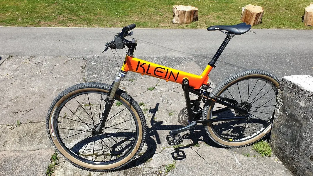

Thought it was about time I did a thread for my klein!
Bought this beauty off of Pete (magpiegifts)
It's a 98 klein mantra race

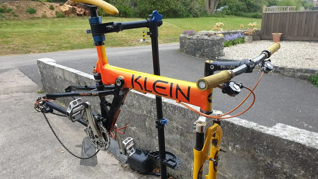

First job... Get it in the stand

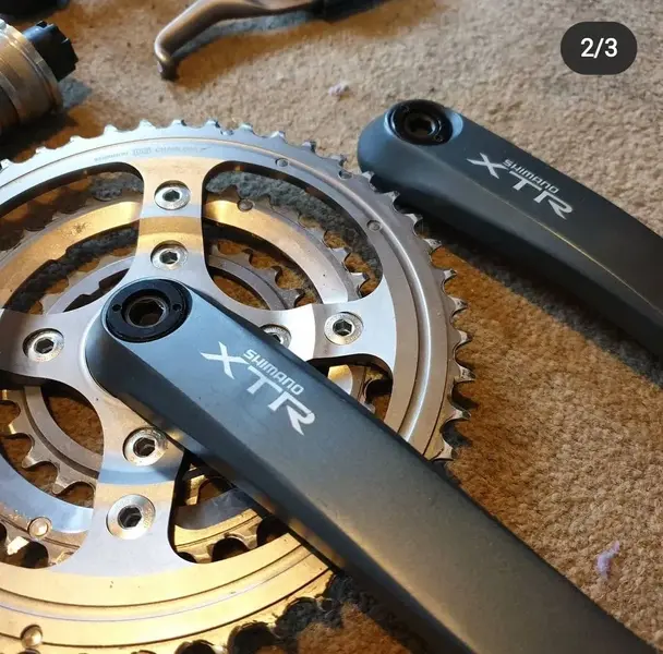

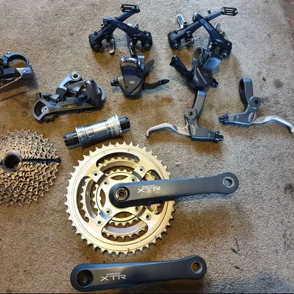

Sourcing a m950 groupset was pretty hard!

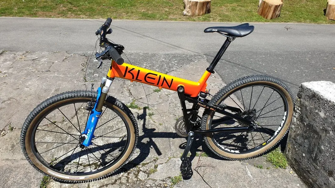

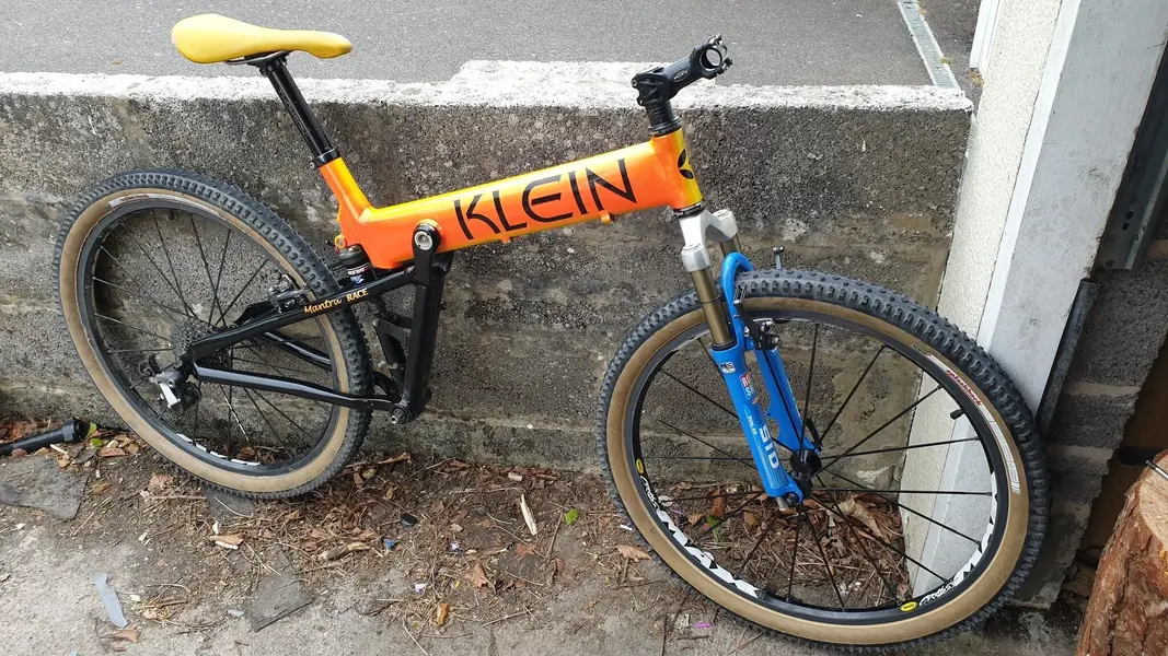

Change of fork and wheels put on
Groupset installed and wasn't sure on the blue sids so tried it with a black set. Think I prefer the contrast of the blue but find the black matches better?

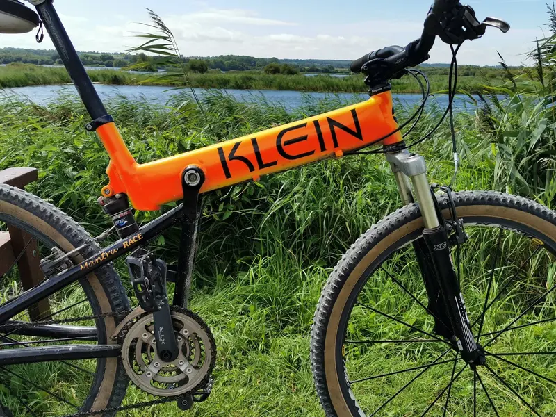

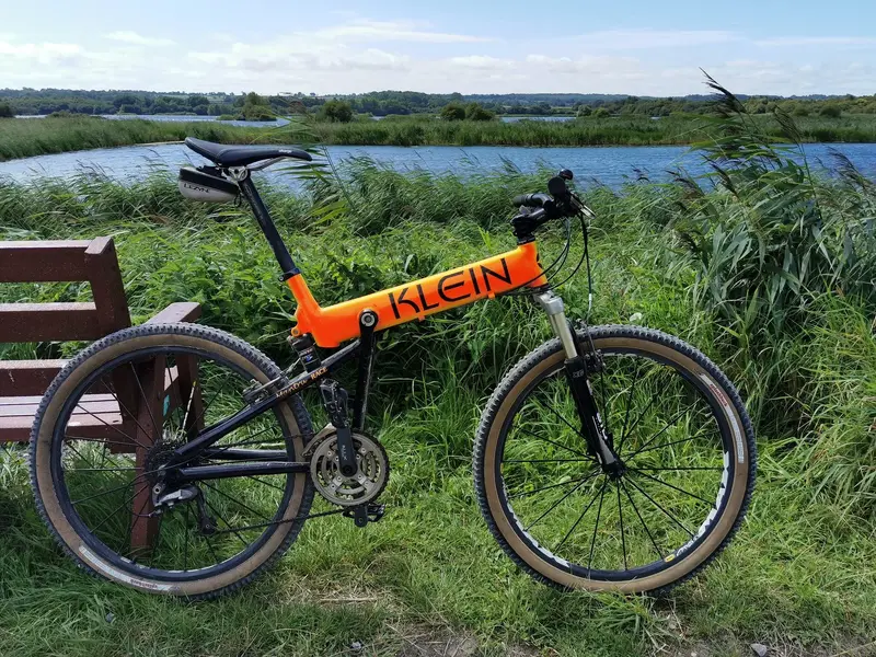

As she sits today:
Frame: 1998 klein mantra race
Rear shock: fox rp3
Fork: rockshox sid xc
Wheels: mavic crossmax ceramic
Tyres: charge splashback 2.1
Groupset: shimano xtr m950/1/2

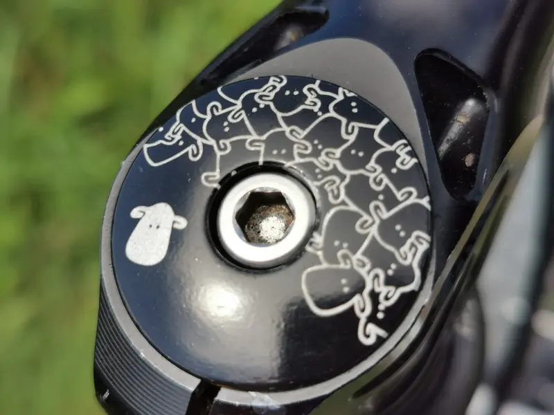

Headset: hope
Stem: hope
Seatpost: hope
Bar: Easton monkey
Saddle: charge spoon
Pedals: wellgo mg-1
Cables: jagwire pro
