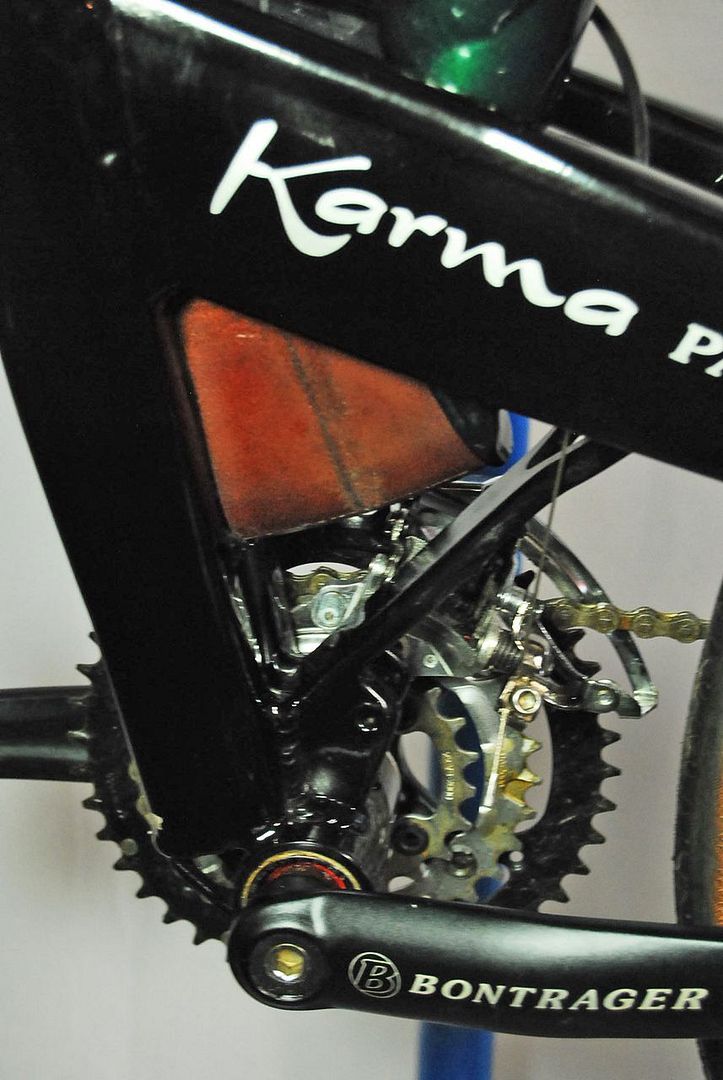

Howdy, this is my first post on these forums. Coincidentally, I own the exact Klein Karma MTB that PACERC250T linked up above (The orange and black leaning against the white fence. Bought it just a few months ago via craigslist here in Los Angeles) and have been riding it quite a bit this summer. Great and cushy as a road bike, but as an MTB it'd prolly be lackluster for anyone who isn't a beginner. The rear elastomer suspension is still in good working condition, although my guess is it's more spongy/bouncy than it was when the bike was new.
Since picking up the Karma, I too have been hunting for a backup elastomer just in case the original bites the dust. Unfortunately, my hours of searching came up with zilch. If it'll help get something crafted, I can yank my rear suspension and take measurements/pix or something. Perhaps even find the proper stuff to make a negative mold (w/o damaging the current elastomer) and ship it to the crafter.

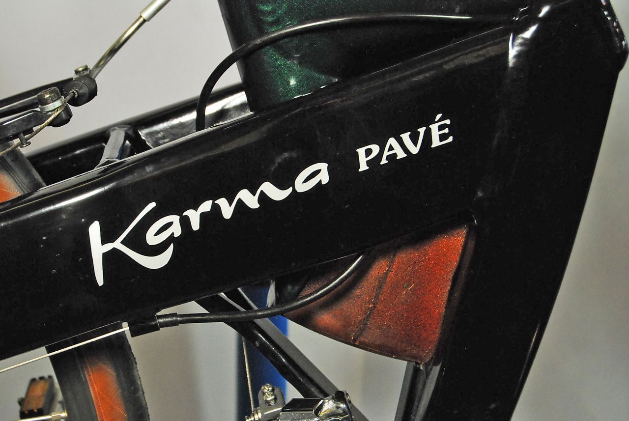

Anyhow, here's a couple other pix dug up when I'd been googling. Not of my bike, they're of a Pave model, but looks to be the same as what's on my bike.
yeh , its the size and the shape thats the problem , my supplier does them in all sorts of shapes , even triangular
but just not that size shape , was hoping to get one big square and shape to fit
not given up yet :wink:
Slow response due to our being out of town, just got back in from our flight. Either tomorrow or at worst this weekend I'll yank the rear elastomer off my bike and get some measurements. Prolly just trace an outline of it from a few angles onto some paper, then scan the image.

I've heard back from the elastomer company and they've offered to make one as detailed below:
Hi Pete,
Its hard to see what the elastomer needs to look like. We can make a
custom kit that is 4"x 4"x 1.5" with a .5" hole or solid? Will this work?
Thanks,
Jim
www.suspensionforkparts.com
P.O. Box 1001
St. Teresa, NM 8008
1-866-296-0058
Sounds promising :D
