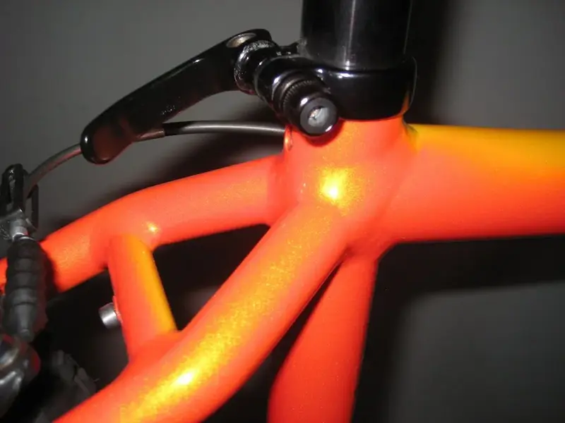

I'm not able to comment on whether or not it could be repaired via welding but I'm sure others on here can chime in on that. I'd think it could be repaired and then just make sure you use a long enough seat post. If it can't be welded, it could be cut down at the crack area and then you could use a seat post collar like Klein began doing in 1997.
