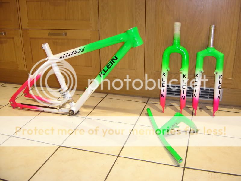

Im currently painting some Team Kleins things at the moment...3 forks 2 MC1's and some frames...
Maybe I can help you out?

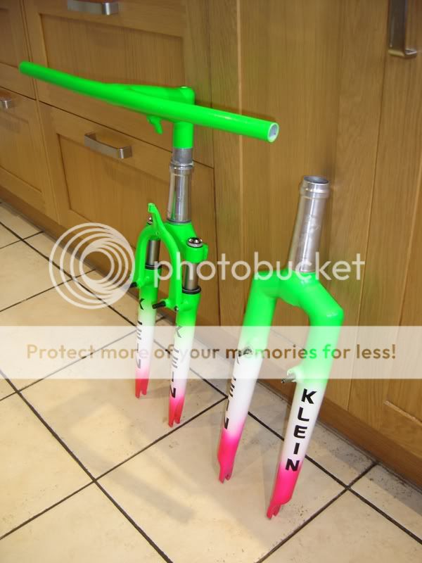

Heres some of my work.....
Box fork is original...
Again frame and 'box' fork original the other forks and MC1 my version.
J
jonrock":2b70j6bs said:
The 'box' fork is squared off at the top...
ie the one the right
J
Ok thanks....always been curious. So the Strata is the 'unicrown'/curved version on the left?
I think the curved is the Unicrown the Strata is the Adroit verion with larger holes in the bottom and has Boron in them... :roll:
Carsten will know..
J
