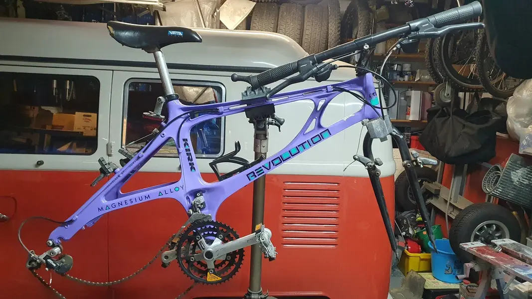

Another one for the E-Stay collection. Found it locally this winter for not alot of cash. It is very original and the paint is in good condition (apart from the fork). A few scratches to the decals.
Either 1991 or 1992.
It weighs a ton ! I know these frames are not light but it looks like the bars, stem and seatpost are made of pig iron. 20230326_194326.webp

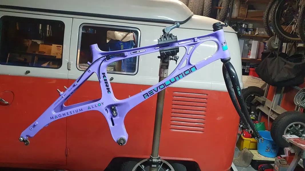

Frame stripped and I can confirm that the bars, stem, seatpost and saddle are really heavy so lots of opportunities to shave a few kg's off.
Any ideas how to get this BB out. I usually use my air driven impact wrench on shimano style bb's but this as a 36mm wrench one...I have a hand wrench but it's not budging even after soaking it it oil overnight. If anybody can suggest a suitable attachment for my impact driver that would be great.
Lots, and lots, of wd40 also remember leverage is your friend
My wrench slips easily off the flat sides so finding it difficult to get decent leverage. Hence wanting to try and find an attachment for my impact driver as with standard shimano bb's it works really well
I don’t think there is an attachment for something like that, or at least I haven’t heard of one. Can’t you make a jig thing using the bolt of the crankset to push the wrench down flat against the frame so I’d doesn’t slip off?
