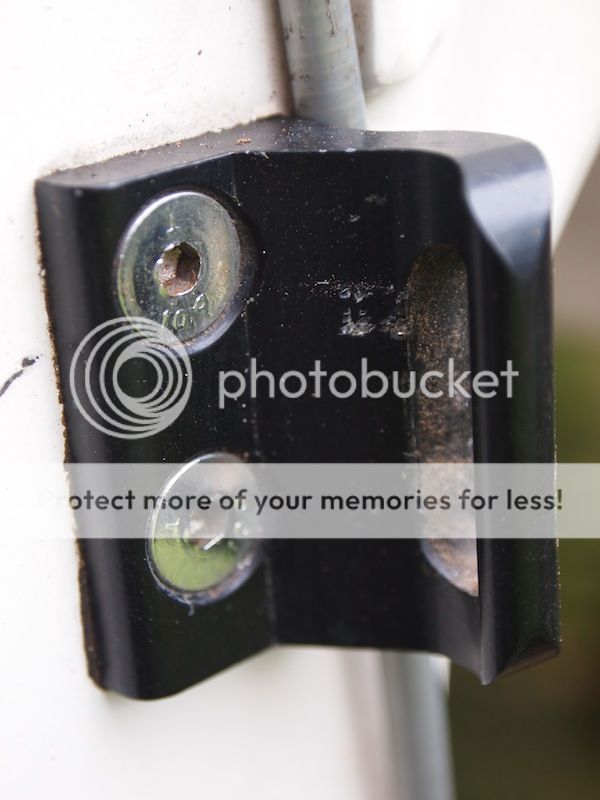

Yup, the MTB version:
The hanger:
It's held on with a nasty expanding plug and a self-tapping screw. Probably best to replace this with a chainring bolt. As you can see, my hanger's already split.
The front mech hanger:
The rear hanger is 28mm centre to centre. The front mech is 18mm centres.
They're both Kirk specific parts, so I'll do some files for you...is STEP/IGES OK?
All the best,
That's perfect. The extra pictures are really helpful. I'll definitely get it machined from Al and use something like a chainring bolt on the rear.
STEP/IGES would be perfect. Thanks so much. Hopefully it'll be a useful resource for other folk too. I might come up with something inventive for the cable guides.
