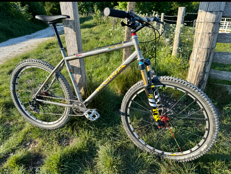

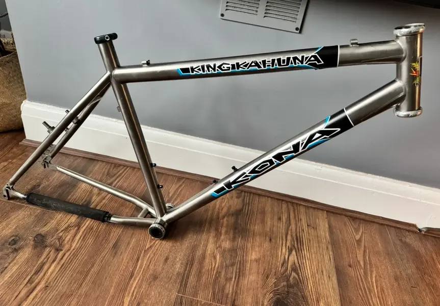

**update, I’ve taken off the decals and added the correct ones I got from Gill and I’ve changed the decals on my Fox forks ready. All I need to do now is buy some disc brakes and a chain and I can build it**

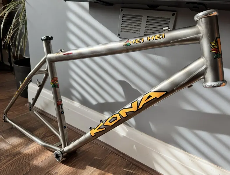

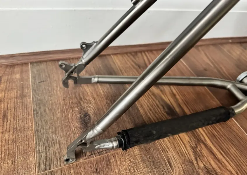

So….. most of you will be familiar with this frame which @Splatter Paint kindly sold me last week!
Plan to is build it up with modern gear to make it different, and to make use of the pretty unique disc tab which I’ve been told Pip believed was factory installed by Kona despite it being a 97 frame (it’s on the register under 97).
I’m probably going to change the decals to the yellow 97 ones too.
First job atm is trying to decide which forks to get, I’m looking at a few pairs of Fox around the 100-120mm range to get something that looks cool and doesn’t flex at all (I’m done with Rockshox SID’s flexing left, right and centre).
Any recommendations on forks and wheels will be greatfully recieved! Thinking Hope hubs and I want some really fancy looking rims (so I could be tempted by some Crossmax SLR’s too).
Will keep posting back progress on here, but it’s likely not going to be a quick build as I’m going to take my time sourcing the parts I want and I don’t have all the cash to throw at it atm.

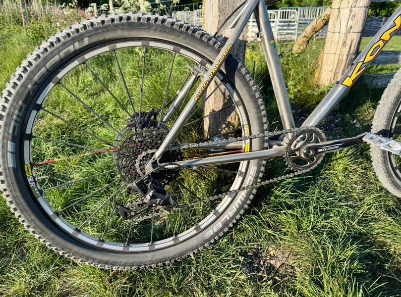

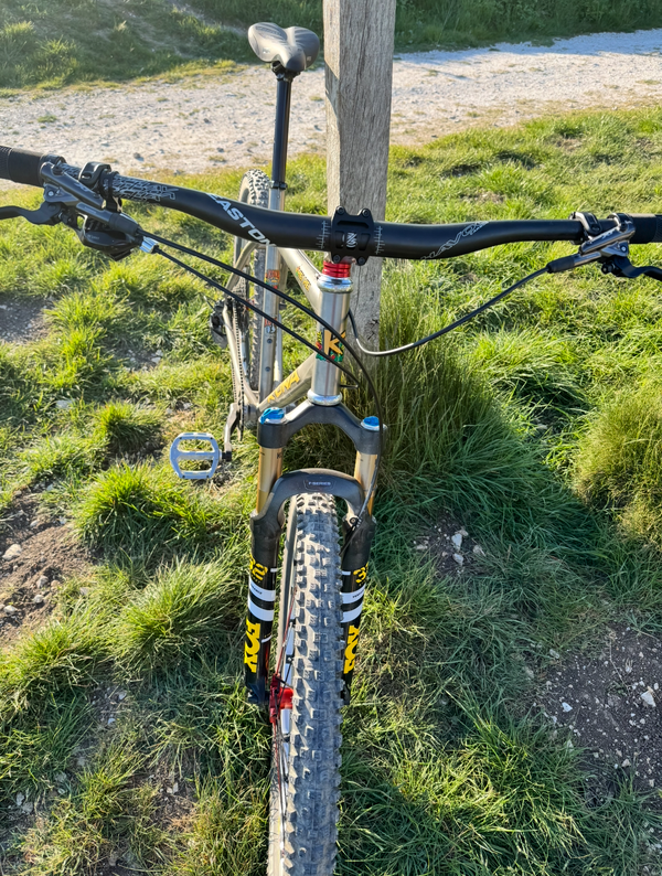

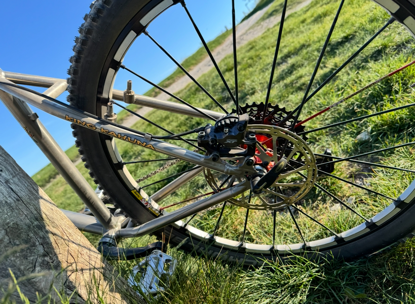

IMG_6185.jpeg IMG_6191.jpeg IMG_6189.jpeg IMG_7205.webp IMG_7204.webp IMG_7254.webp IMG_7253.webp

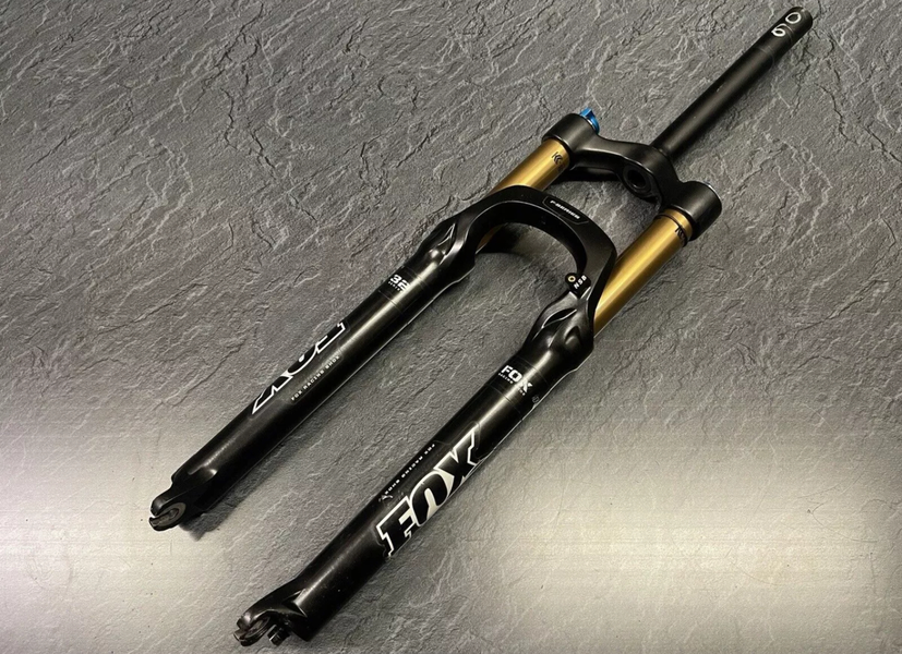

I’m looking at these, I know they will be heavier and 120mm might be a bit much but I think they will look really cool and ride well with modern disc wheels

The axle-crown measurements will be the killer on a modern fork. The F100 was fine with a short stem and risers, but awful on flat bar.
