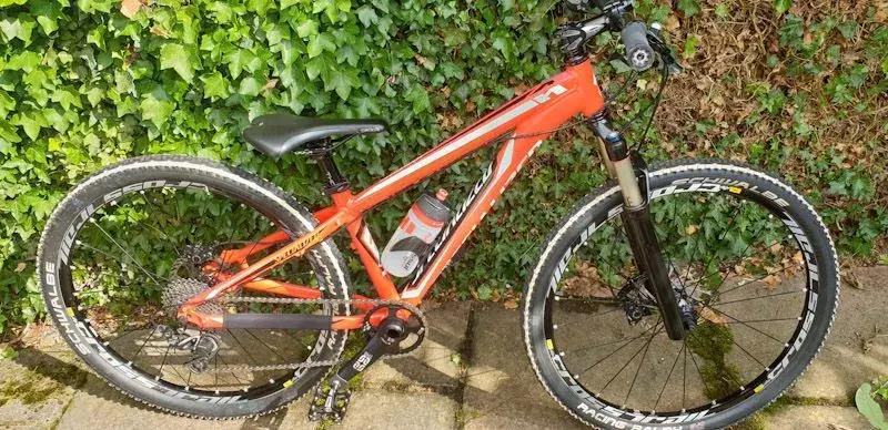

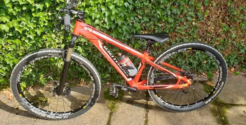

After a failed attempt at a more retro build using an orange gringo frame, I found a specialised hardrock frame on Ebay and decided go to town with it.
Aside from.a bit of paint fade and a few chips, the frame was in decent shape after a clean, tax-cut and polish.
As the gringo was v brake, I had to.raid my spares stash which wasnt exactly kid bike specific, so ended up having to use some decent kit not usually found on a kids bike. It has turned out quite nicely so thought I'd share.
Frame: Specialised hardrock
Forks: Rock shox sid rlt
Wheels: Mavic crosstrail
Tyres: schwalbe racing Ralph triple compound with a white stripe
Gears and mechs: shimano deore 10sp
Brakes: shimano deore disc
Cranks: e-thirteen trs
Stem: Hope
Bars: Use atom carbon
Grips: Cannondale grind lock on
Headset: Cane creek s-3
Cassette: Shimano Deore 10sp
Chain: Sram 10sp
Seat post: Thompson
Saddle: Selle royale
Pedals: Wellgo c161
Seat clamp: Specialised
Rotors: Avid
Bottle cage: carbon
Cables: shimano xt

I did similar not long back and thought the hardest thing was getting sensible length cranks, there are basically no short options. What length did you go for?
Is it a 26"?
I went for 165 cranks as it is the only readily available short crankset I could find of suitable quality for the build, and yes 26 inch wheels.
I hope he looks after it.
I was trying to get hold of a set of these cranks, which I think look ideal:
https://www.srsuntour.us/collections/cr ... 5338041742
In the end I couldn't get any, the importer told me they didn't bring any that size in. Ended up buying a set from the Frog spare parts list, the ones with the plastic guards.
We built a Felt 12" frame with some Duke forks, 9-sp XTR mech and a rare SLR saddle with the troy lee designs spider print.
I used 150mm, 110bcd double cranks from Paul milnes cycles, and a single 34t ring for my lady's bike. It's flat round here so no need for a smaller ring than that. Found them on eBay
