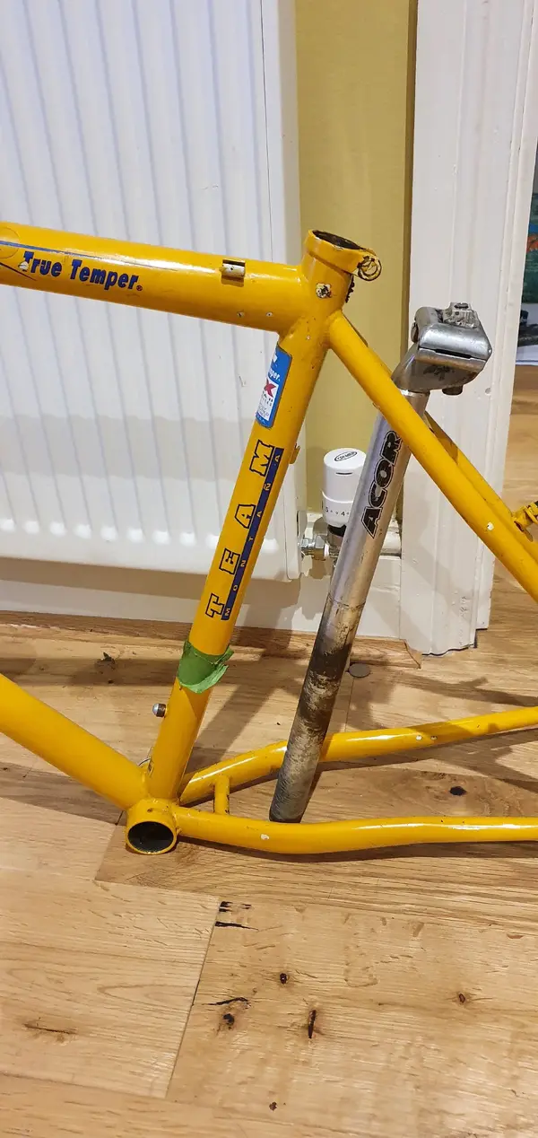

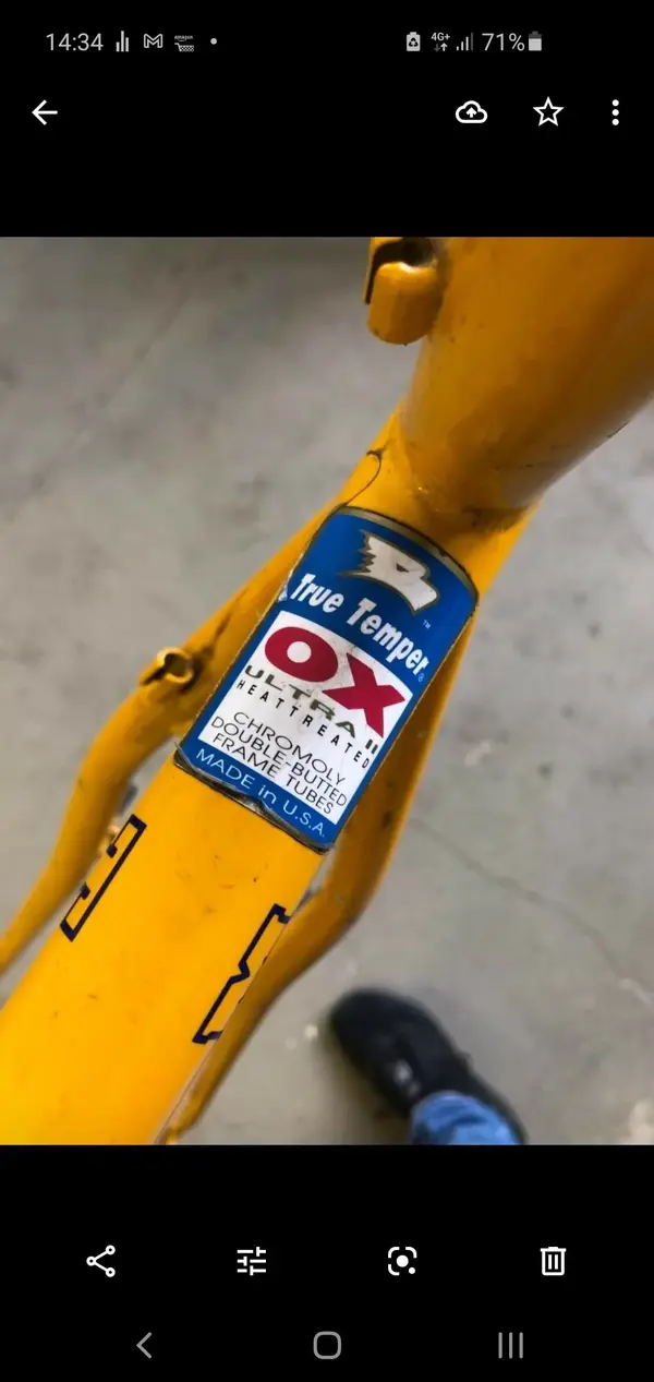

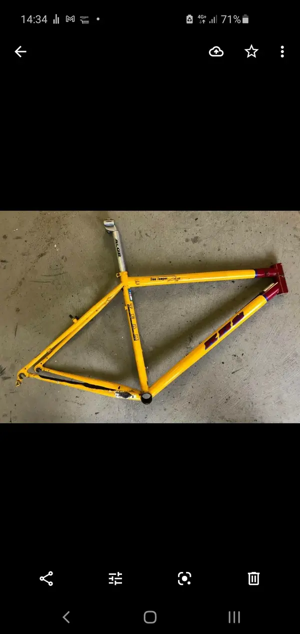

Hi,
I wonder if any KHS gurus can tell me anything about this frame. Seller thinks it was originally purchased in Hong Kong.
I found what i think is an accurate spec sheet here:
https://www.bikepedia.com/QuickBike/Bik ... item=50485
But, very few references or images anywhere else on the Internet.
Deciding how much effort to put into removing a very stuck seatpost....
Thanks

Not seen that colour before. But it will be worth it, KHS are good and ride well, there are a few on here and I don't remember ever reading anything bad about them

Thanks for the tip, i read about the freezing method before. One challenge is i don't have a vice, so I'm working with some limited resources. I may try and find a cheap one to give this a try, i may try vinegar down the setatube as a cheap next attempt....!!
I've had success after soaking a stuck seatpost with coca cola for a couple of days. Maybe not quite as quick or effective as the freezing method, but cheap and easy and worth a try!
Other then the front mech cable being routed on the left of the top tube, the frame looks very similar indeed to my collection of 88-93 steel Montana's. They do ride well but only had a UK importer for a handful of years from 92/3 onwards hence a relatively low profile here.
My 88 and 89 Montanas are also from Hong Kong. They have stickers on the frames from the shops they were sold from.. I always wondered how they started out in HK then ended up in blighty..

Thanks for that. I bought the frame with a respray in mind, but I'm quite intrigued to have something that seems to be relatively uncommon, with few images anywhere. I'm now minded to keep the colour and just try and touch it up or clearcoat it. Nasty bit of chainrub and a few bad areas around the drop out need looking at....
Vinegar soak, an adjustable spanner and another old seatpost for leverage did the trick...thanks for the tips...
