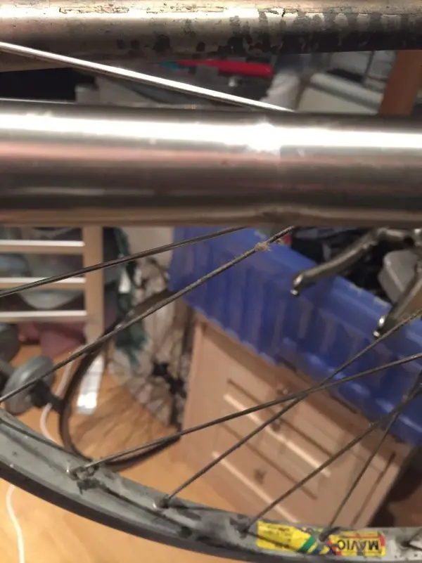

ibbz Gold Trader rBotM Winner 98+ BoTM Winner Karma King Dyna-Tech Fan Feedback View Sep 23, 2015 #11 Pics please !
Kell Retro Guru Sep 23, 2015 #12 Re: Here you go. Attachments IMG_6602.webp 109.8 KB · Views: 199 IMG_6603.webp 94.7 KB · Views: 199
