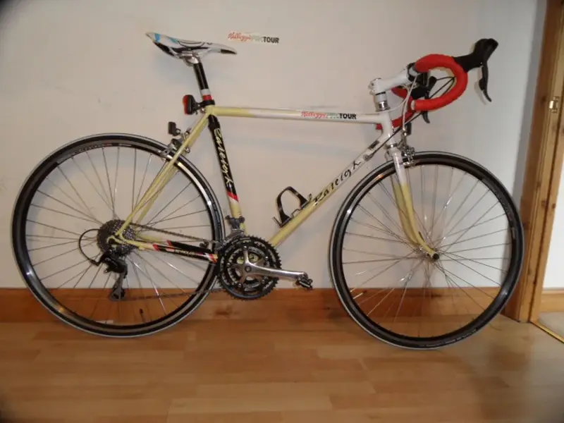

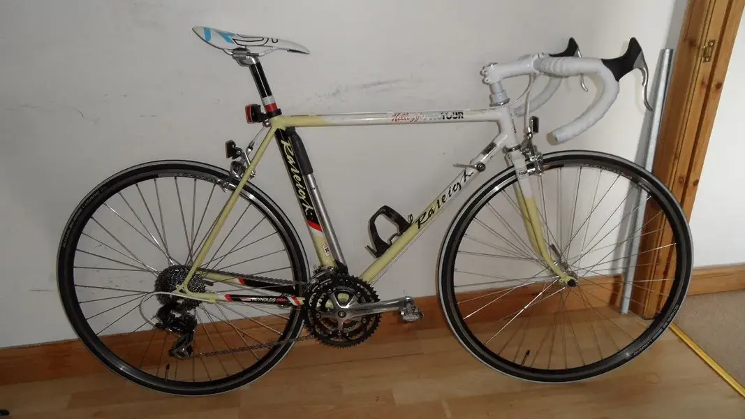

RSP bars and Stem came today. also changed the crank (again :wink: ) and fitted aero levers.
Full Spec (Today's Edit 25/05/14 :roll: )
1988 Raliegh Kellogg's Pro Tour
Shimano Tiagra 30/42/52 Chainset
Shimano Tiagra Aero Brake Levers
Shimano Tiagra Dual Pivot Brake Calipers
Shimano Tiagra S.I.S (rear)/Light action (front) 3x8 speed Shifters
White outer Brake Cables
Shimano Tourney Direct mount Rear Derailleur
Shimano Deore Triple Front Derailleur
Shimano SPD pedals
Sunrace 13/15/17/19/21/24/28/32 Screw on 8 Speed freewheel
Sram PC970 chain/Power link
Weinmann XR18 rims 700c Quando QR Hubs
Swalbe Laguna 700x23c tyres
Raleigh RSP Pro Race Lightweight Road Cycling Saddle with CrN/Titanium Rails
Raleigh RSP Frame fit pump
Raleigh RSP White Aero bars 42cm wide
Raleigh RSP White 1-1/8" stem clamp with oversize 31.8 handlebar 4 bolt clamp, 110mm reach
Zenith 1" to 1-1/8" Alloy quill to aheadset adaptor
Giant XTC microshift Alloy seat post

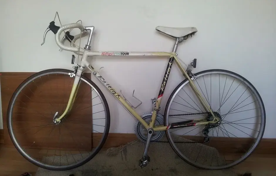

Original Spec (as I bought it)
Weinmain 116 Alloy wheel front (rear aftermarket made of chocolate odd bod alloy)
Weinmann 570 side pull calipers
Weinmann Alloy brake levers
SR Custom 42/52 chainwheel
SR Custom 60mm reach Stem
Raleigh engraved alloy handlebars
Raleigh White aero friction shifters
Maillard? 14/24 6 speed freewheel (24 spline, unbranded?)
Sachs Huret Derailleurs (front and rear)
White Seat and fluted alloy seat post

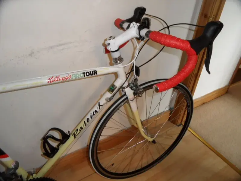

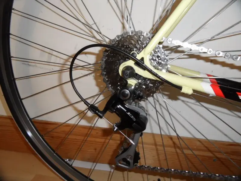

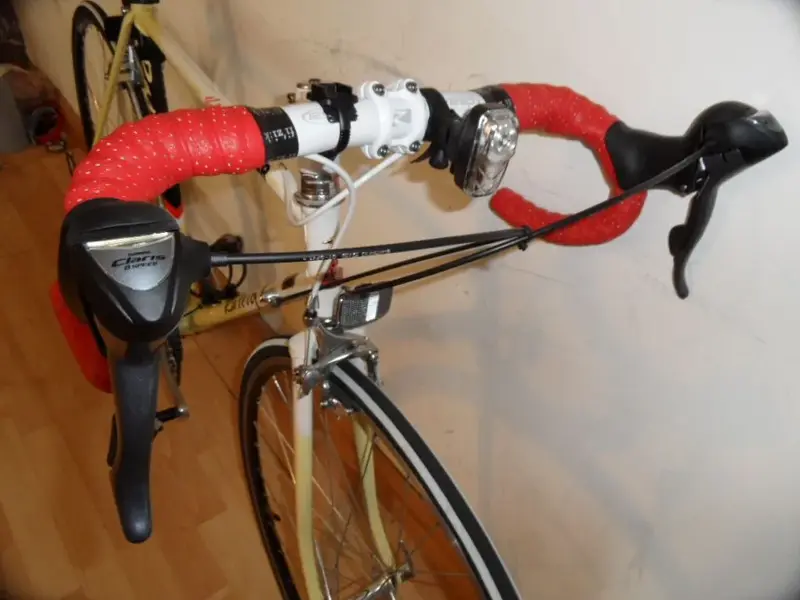

Well I've been playing around with the old KPT again :facepalm: , fitted a Shimano 105 rear Mech. Freewheel out and in with the Shimano hub/Freehub and Sram PG-850 Cassette, got a couple of them depending on the ride (yep I'm a wimp :roll: ). Back to the red handlebar tape. Shimano Claris 3x8 brake/shifter thingy's. New decals have arrived and saved for a rainy day when I get around to getting the paintwork sorted.
