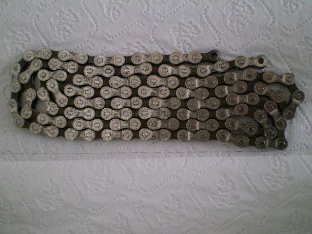

Hi Larry,
from the pics i would say your bike parts don't need replacing.
All they need is love... in form of some ethyl alcohol and some grease. :D
If you want to replace something maybe you could buy a new chain but if you don't want to you could refurbish that, too.
Here is a pic of a chain that looked like yours after one day in ethyl alcohol and an hour with a brush.
