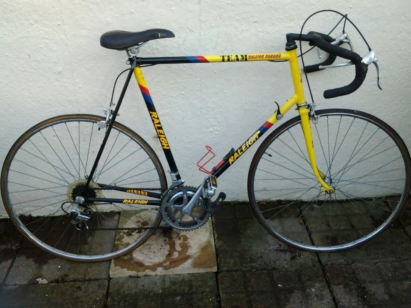

seeing as i Haven't posted much I thought it say hi, Just bought a Banana, absolutely love Raleigh bikes, Had my fair share over the years but never have I been so lucky as to own a Banana up until last week.
plan for this restoration is to go rat rod, the frame set will be the same but im adding a shimano 105 group set and some new modern Mavic rims and Hubs. so far the project has been pretty easy, the dropouts didn't need bending to take the 130mm rear wheel not did it need forcing.

This looks like one of the bog standard raleigh replicas, not one of the decent ones. That maybe why the numbers don't make much sense.
Frame number will be on the back of the seat tube, towards the top.
It will start with an 'N' denoting that it is (as for pointed out) the 18-23 entry level bike

tbh i wasn't expecting anything more, just happy to have something that poses so much nostalgia to me
the frame is in reasonable condition so will do me for a while.
cant seem to find any numbers on the seat tube either, weird. could be a fake?

its a big un! Hope that either you're over 6ft tall or not bothered about having any more kids :wink:
The paint on these bikes can sometimes be so thick that the frame number 'disappears' but it'll be there somewhere (on the back of seat tube)
I believe it's a 1988, based on the fact it has the Raleigh Team Banana top tube decal, as the 1989 bike just said Team Raleigh
Probably a late 88 model, based on the Shimano SIS gearing, as the earlier one's had Sachs Huret

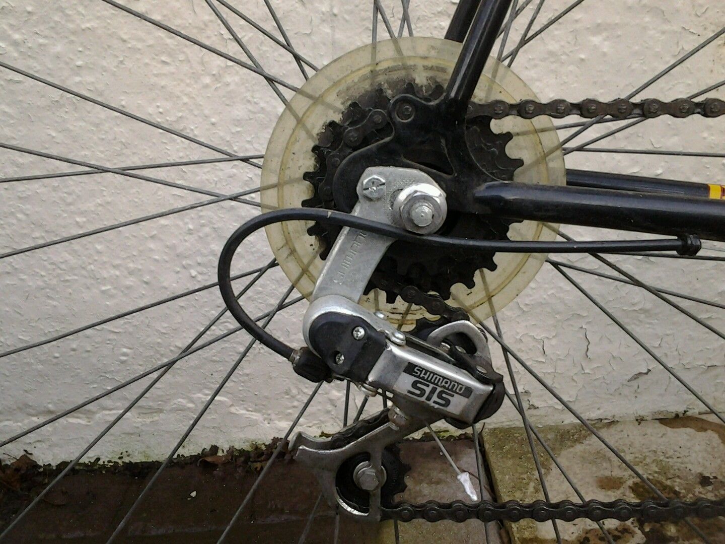

Looking at your pic of the current rear mech set-up it looks loke the frame doesn't have a hanger integral with the drive-side dropout. The 105 mech will not have its own hanger so someone reading this May be able to tell you what you'll need to source to be able to fit it.
