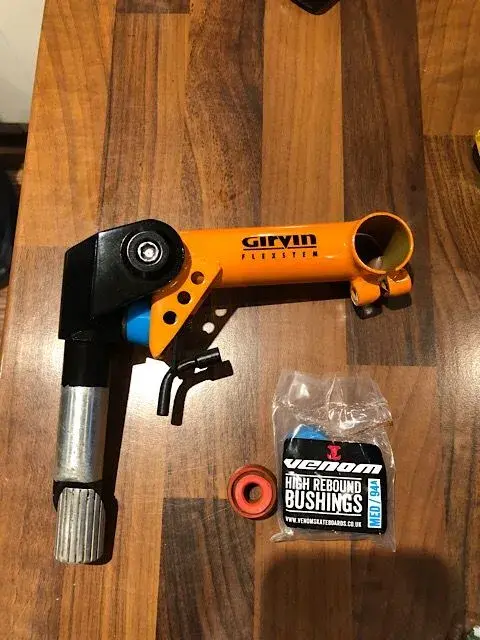

Looking good mate. I’m in the process of doing mine too. I’ve colour coded my Flex Stem to go with the Orange. Ive not put the decals on yet, paranoid I make a mess of them. Lolol
