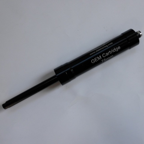

I have a Risse Gem damper in my SLs, it's a beautiful little piece of engineering and you can still buy them!
Website here:http://risseracing.com/store/produc...d=106&osCsid=02f7f6a6c45338b922b9a63be67f13c4
I've also got the Risse cartridge, bought a few months back direct from them. As above, fantastic bit of kit.
Along with the kronos springs which are currently available on ebay in medium and firm weights.
Transformed my Judy XC :)
