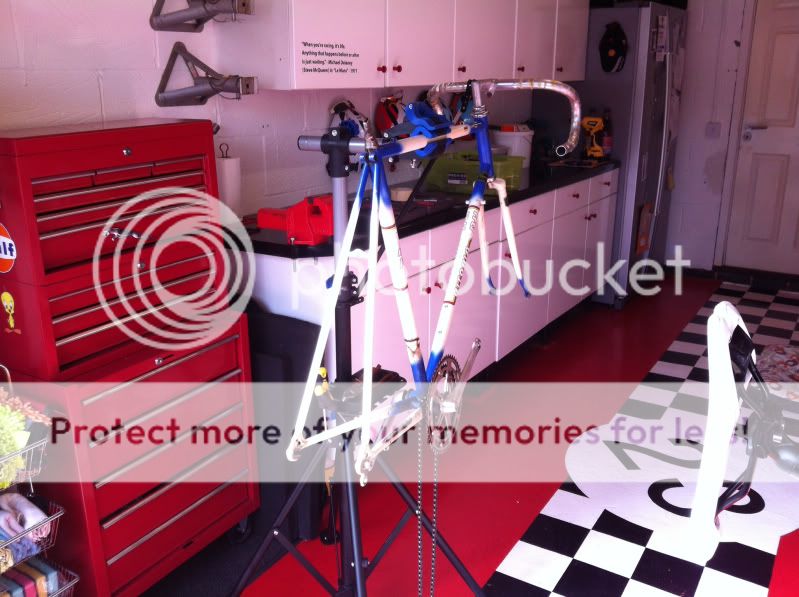

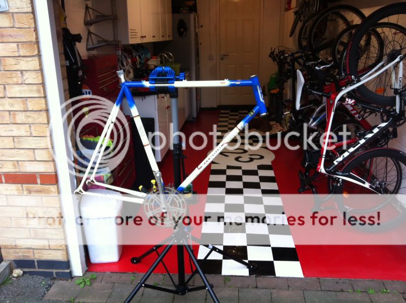

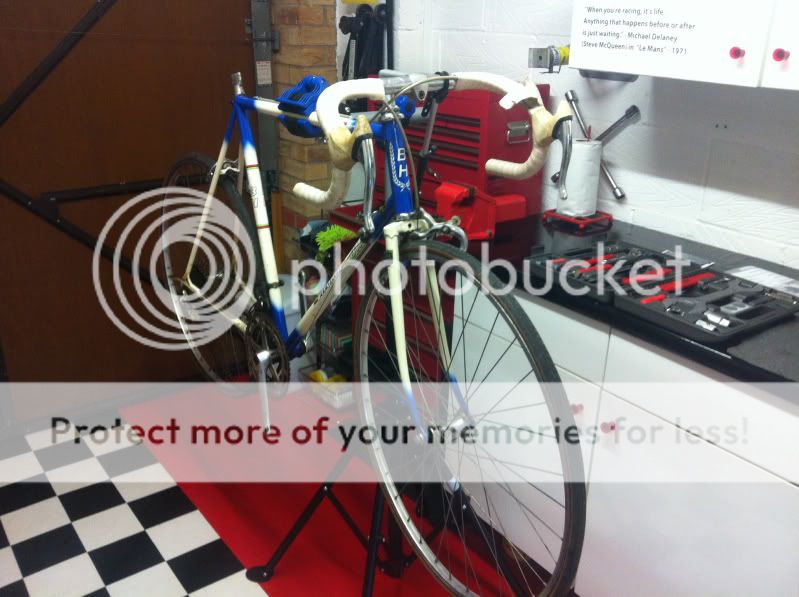

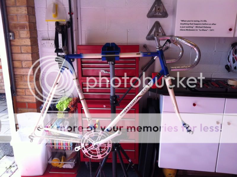

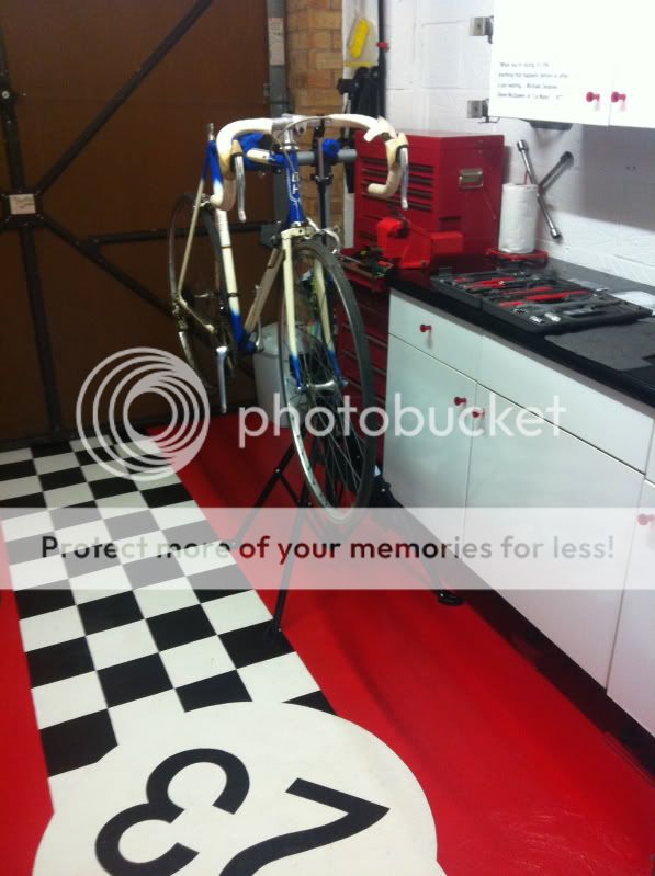

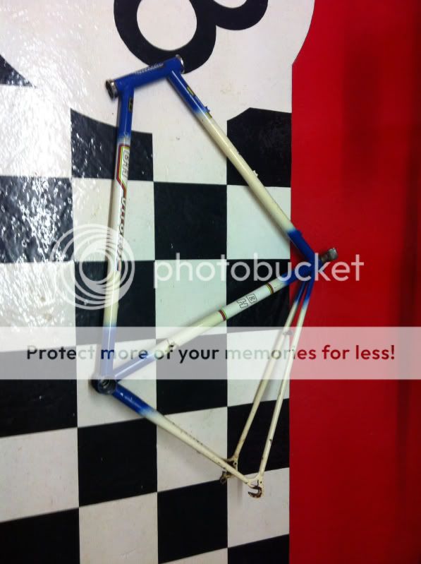

So, here are some images so far!
Now need to get a 38mm spanner to remove the BB cup

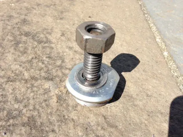

If your replacing the BB cup then it's easier to put a large bolt with a washer through from the back, a washer and nut on the outside and when you tighten it up the cup will come away from the frame without too much of a problem

Nice collecton :) might be easier to get a local bike shop to remive the seat post. I worked at Manchester uni 1987-2001 :)

For the BB, considering the age and mileage, never been replaced or serviced then a replacement makes a lot of sense, however need to see if these are available in this size etc. The BB is actually in remarkable condition, maybe just bearings are required. Haven't looked into that yet. Suspect the answer is to hand on this site? If so, will use the washer and bolt trick to remove, but will still need a spanner to put the new one on?
Yes, worried about damaging the frame when trying to remove the seat post! Should leave it to a professional I think too!

What I do when using this method for removing stubborn cups is hook up an impact air wrench at quarter power and let the impacting slowly remove the cup…never found one yet that can't be removed
Hi, if your BB looks in good condition, then I would say try and save it, new set of loose bearings cost a couple of pounds, get a proper spanner to remove the cup, the washer method will probably write the cup off. As 47p2 wrote only use this if your gonna replace the BB. Or get the bike shop to remove it when they do the seat post.

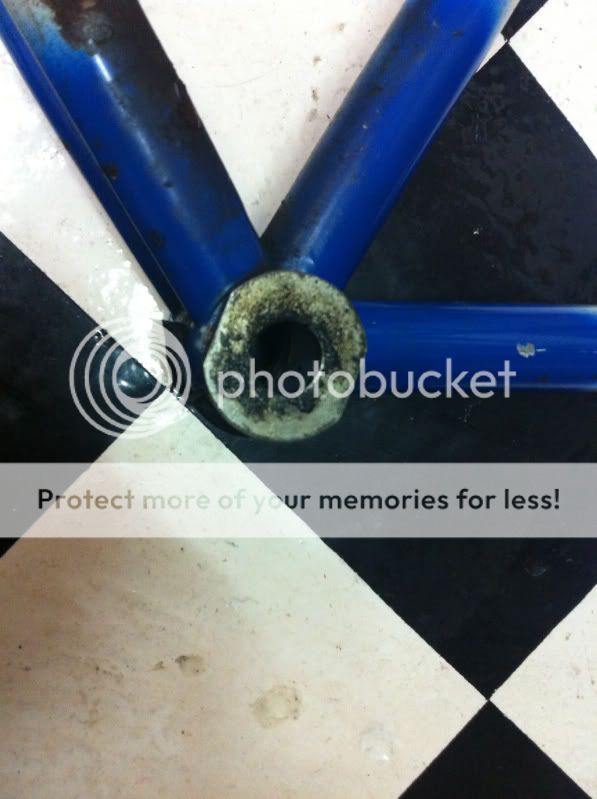

Thanks for the advice all. Managed to remove the bearing cup without damage using my bench vice and a little care. Glad I did as it has BH markings on it, will be able to keep it and re-use.
The next puzzle will be the bottom bracket cable guide. There is no external screw fixing. Can I remove without damaging? Not sure if I can get the exact same one new or not.
TurnS out the bottom bracket cable guide is a push fit interference, so just carefully prised it out with a flat ended screwdriver. I can use that again, which is great as I cannot seem to find anywhere that sells them the same.
