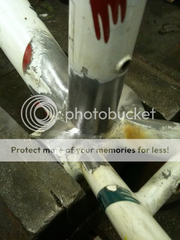

Well, thats the ugly disc mount gone. Now into the blast cabinet.
Now you see it....
......Now you don't
This is really a win-win, DrS gets to do his thang on a bike he appriciates and jjwoods gets a cool frame at the end!
Yeah, really pleased that JJ entrusted me to sort this frame out. Huge thanks from me. 8)
So, todays progress. Disc tab and brace removed and seat tube repaired. When the frame arrived last night i noticed the tell tale blisters around the bottom of the tube straight away. Paint removal showed 3 holes of around 2mm diameter and a crack on the drive side between two holes. I set about cleaning as much rust out of the tube by gently tapping the tube with a soft wood flat, before fitting a long wire brush probe down the tube fitted to a die grinder. Quite a bit of rust came out but not as much as i have seen before.
The repair was going to be tricky as it was so close to the weld. First off i opened up the holes with a 4mm drill bit and checked that i had exposed good clean metal. One hole had to go larger- not much but just enough to get clean edges. I then made up 3 plugs, carefully filed to size and shape which went into the holes. These were then carefully tig welded into place with short bursts to avoid overheating the thin tube. A little cleaning up with files and paper was all that was needed to complete the repairs. There are a few small dimples around the welds which i expect the powder to cover without resorting to having to silver solder- thus adding more heat stress to the frame.
I really didn't want to put a new tube in as i wanted to keep as much of the frame original as possible. The plugging technique is something i use on old car chassis often enough and has proved to be well up to the job. My Yo was also repaired the same way over 9 months ago and is still as good as the day it was done.
The frame needs dipping in acid now to get rid of the paint and all the remaining rust before a quick session in the blast cabinet. Hopefully it should be going for powdercoat on friday.
