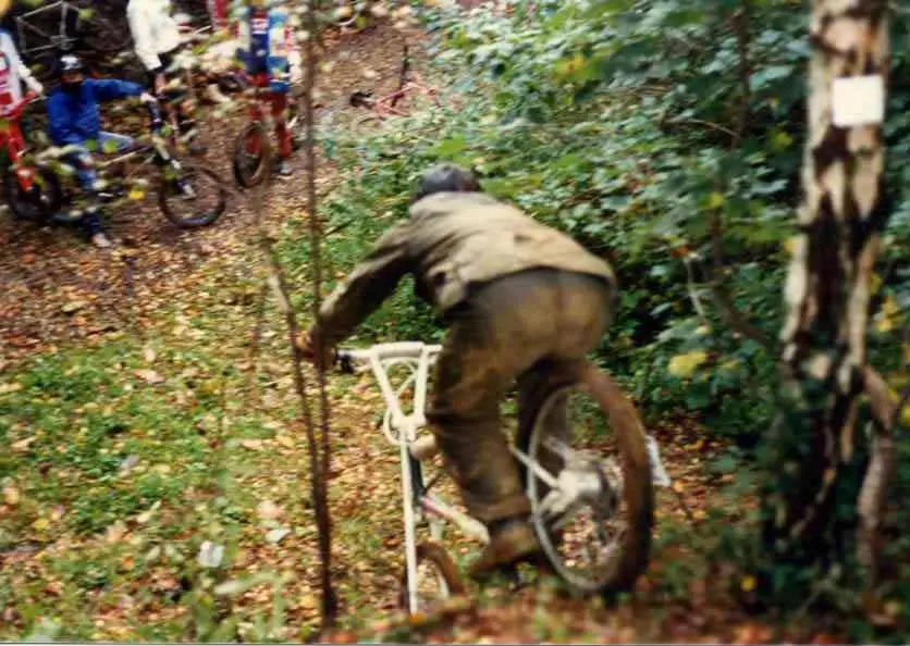

Yes. The Dingbat evolved over time:
phase 1= un-braced frame, (standard forks)
phase 2= single brace added, (standard forks)
Phase 3= triangulated and braced forks added
Whaaaa!
Both the pics of this bike are missing the engine :) I don't mean that it should have one o course :oops: :lol:
The newer 24" trialies & bmxs used in the same competitions just look like bicycles being put through their paces (and yes, i've seen the youtube clips of what they can do :twisted: )
The stance of the bike looks very motorcycle trials, as does the riders position on the bike. I know this is stating the obvious, as thats what the design was intending to achieve (is this the Dingbat shown earlier in the thread???), its just that its the first time i've actually seen this in a bicycle...
...and now I want one even more heheh

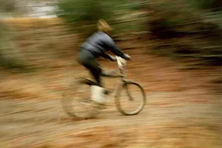

Throw weight back - emergency stop technique...
Best performed at night, on road, whilst using tungsten-carbide studded-tyres. :twisted: (these create nice sparks) :twisted:
Too much front brake however' can result in "lift-off"
There is a technique, that involves vaulting, feet first, over the handlebars and then landing on your feet and running forward.
I've only done this successfully once. When you land however, you do need to remember that there's a flying bike chasing you.
