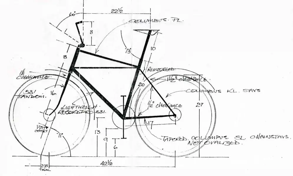

:?: I don't know about the Clelandale :?: but this drawing of a Cleland may be of interest.
This is a drawing of my 1988 Highpath Cleland. I am six foot two and the bike has a 13 inch bottom bracket height so this is a tall bike. That makes me seven foot three if I stand on the pedals.
Other interesting features include: a 110 mm wide bottom bracket to allow for straight chain stays, an un-dished rear wheel and an offset rear triangle to centre the wheel in the frame. Also, the freewheel can be removed with an allen key to allow for non-workshop spoke replacement.
It has twelve, non-index, gears the lowest being 18 inches.

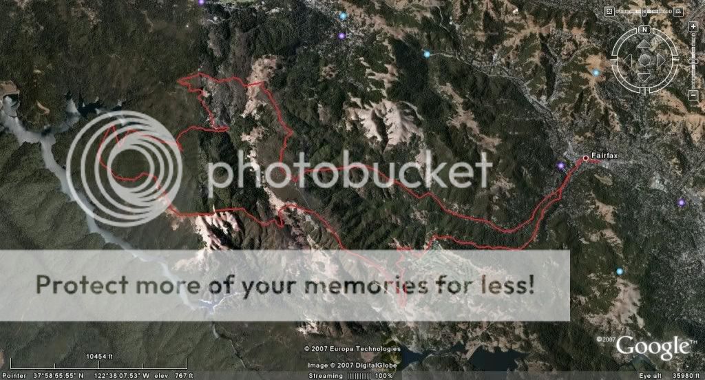

This thread started with a discussion of the Appetite Seminar, our local 30-year plus annual event which takes place in two days.
I just uploaded my photos from the previous two years to my new photobucket album, but here through the magic of Google Earth is the route.

OOOOOO, that route looks mmmmmm.
where's the deep mud?

How was that route devised originally - or did you just make it up for the first one? Looks to be a tough one - how long does it take?
An interesting mix of tubing! How did you manage to source so many different individual tubes? And what made you select the ones you used?
The allen key removable freewheel sounds intriguing. Can you provide details of how this was achieved?
I like this thread, great to find out the 'whys and wherefores' of how bikes were originally designed. Thanks to everyone involved in bringing this info to us all.
Re: What was the rough spec of the Clelandale out of interes
That's very interesting.
What surprises me is that - on the face of it - the geometry isn't so very far from my '92 Stumpjumper in many ways. The frame angles, wheelbase, and chainstay length are almost identical. The bottom bracket is higher, but the big difference is in the handlebar position. The Cleland's fork is longer, and the head tube is nearly twice as long. It's the handlebar position that's chiefly responsible for the weight shift up and back, not the frame angles.
I realise of course that most other mtb designs of the eighties were very different - long chainstays, slack angles, flat top tube - but your Cleland isn't so very far from, for example, a mid-nineties Kona, again with the exception of that very high bar position.
