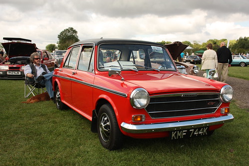

My first 4 cars were Minis, a rust bucket of a blue Morris 1000, a harvest gold Mini 850, a white Mini Clubman Estate (to carry my girlfriend and my canoeing and camping gear), then a black 1275GT whose engine had a rather large appetite for oil. Got the engine and box out of an Austin 1300GT like this
which essentially had a Cooper S engine with same internals.
