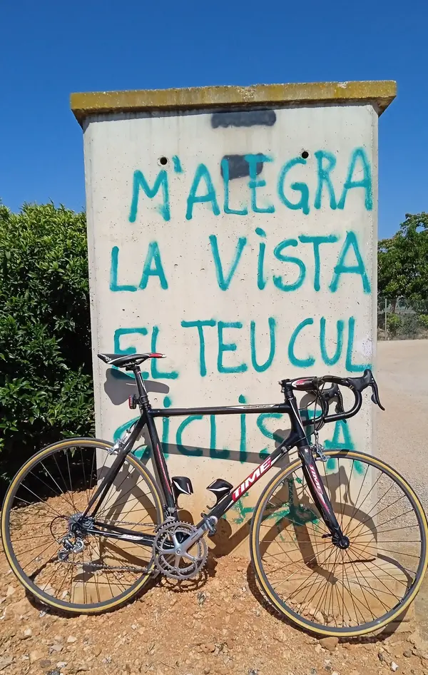

Haven't updated this for a while... The right ergo shifter needed a new index ring as the old one had split. A little surprising given the low mileage, but no big issue. It just took me a while to get round to it. I made a couple of changes - swapped the bars for some deep drop 3T that I had (saved 100g over the carbon wrap ones), and fitted a record alloy chainset (gained 200g over the carbon one). Prologo saddle to match the colour scheme. And some different wheels - miche primato with Mavic reflex rims and some older mismatched tubs that were already on them. The position is pretty much exactly the same as my other bikes, but the 2cm longer top tube and shorter stem make it a bit "twitchier" in the steering. Rides very nicely though! It's definitely a keeper!
Quick pic, with a fun graffiti for anyone who understands Valencian 😜
Nice looking bike, the carbon frame looks quite subtle, unlike more modern ones. I would have thought a longer tt would make it more stable, though.
Yes, very stable but twitchier in the steering than my pinarello paris. But that's a size 54 with a 130mm stem. Longer stems make the steering "slower". It's not that the time is bad at all, just I am so used to the pinarello that it feels obviously different.
