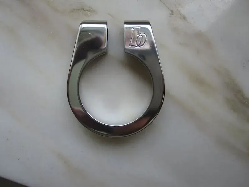

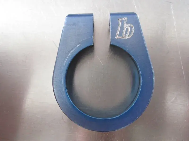

In meantime I decided to play with de-anodization, and since it was my first try I decided to do it first with seat clamp.
Before:
first it was to the caustic soda bath:
after the bath the time for sanding came. I did it with all grades of wet sandpaper from 600 to 2500 and finish it with autosol (well it was not autosol but swedish equivalent).
After:

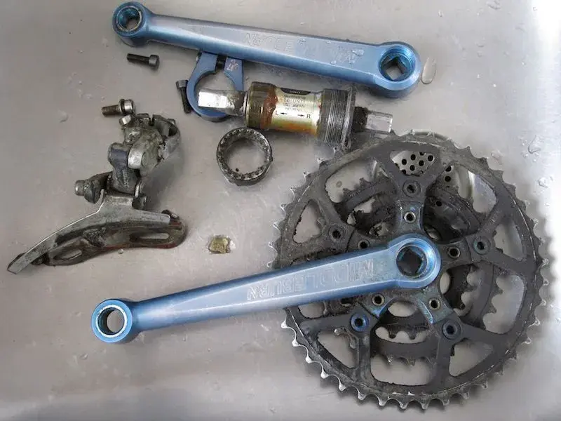

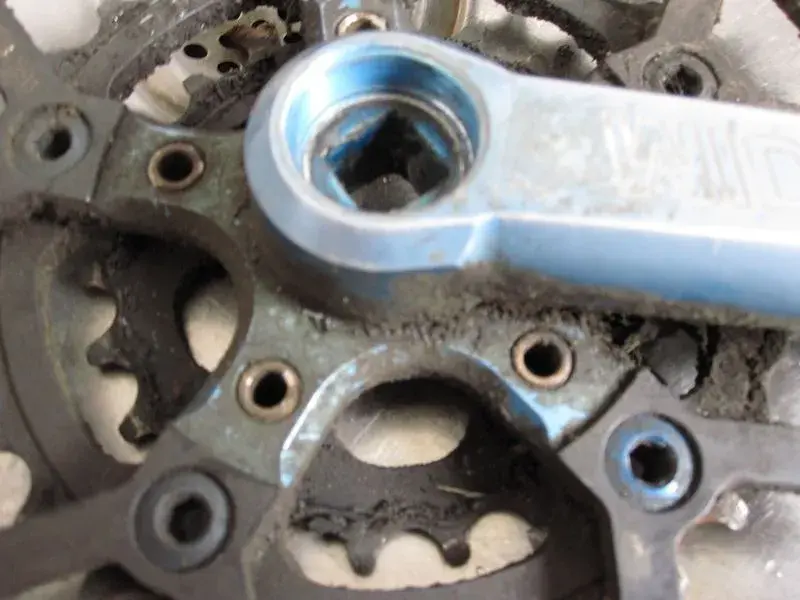

Tomorrow or later today I plan to do the same with cranks which are also anodized in blue but they do not have as many scratches as the seatclamp had so I will try with the swedish autosol right after the bath.

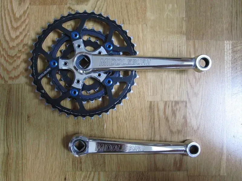

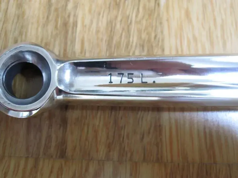

I managed to clean cranks.
They look lovely imho, what do you guys think?
Btw. I have already ordered new (red anodized chainring bolts).

Nice polishing work there, looking great
