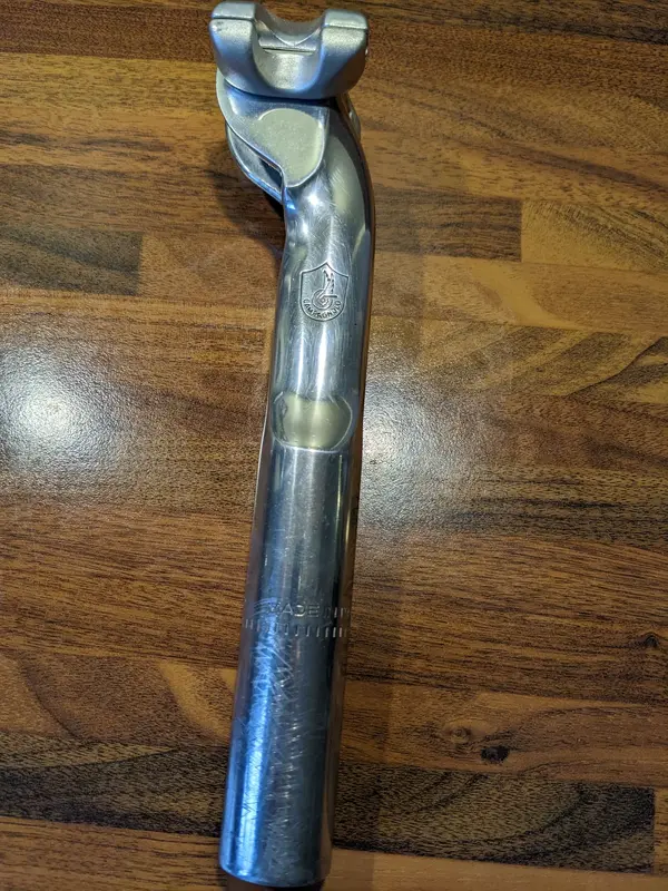

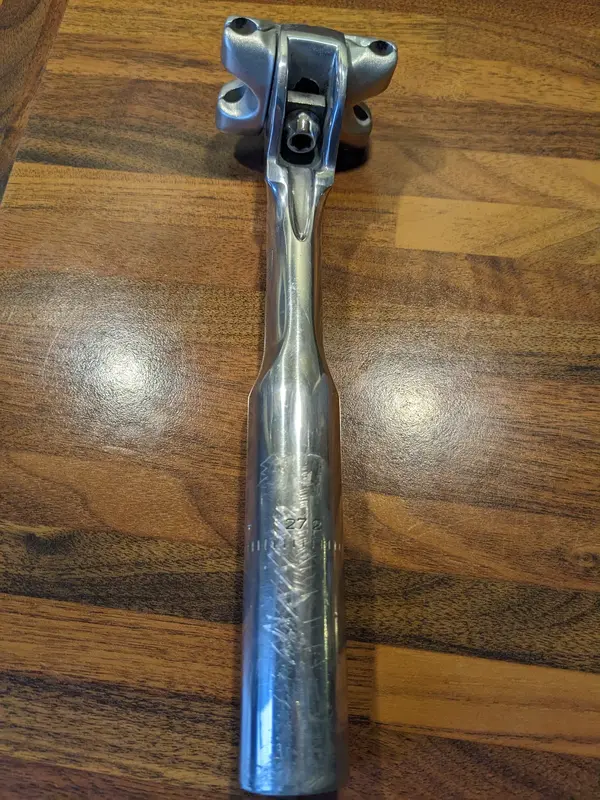

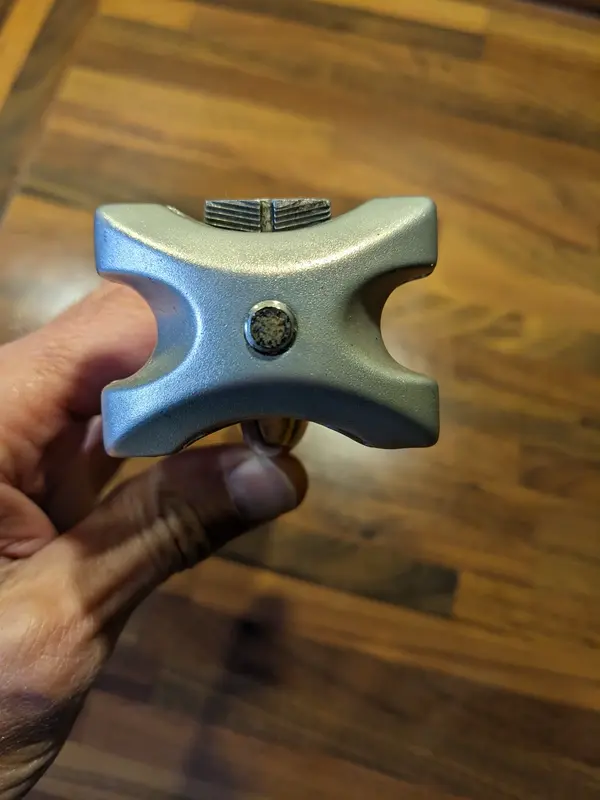

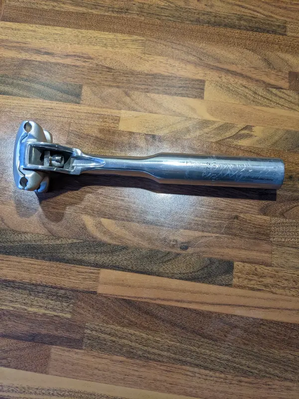

Is this seat post Chorus Aero 1st generation?
forty45
Devout Dirtbag
I've looked into the differences, but having never been "into" Campag I'd appreciate advice from those who know.
Yes ..... sort of. Sold one just like it years ago and remembered it was a fuss. Nice seat-post.
https://velobase.com/Pages/ViewComp...DBE8-416E-A8A6-BD8C4B45DC75&Enum=105&AbsPos=8
https://velobase.com/Pages/ViewComp...9FE-41E2-A812-1858C0099E63&Enum=105&AbsPos=30
From the above the answer was in the length. It is not C-Record for sure.
Thanks, the second link helps as it's a 200mm (measuring from the bottom of the post to the middle of the clamp is 200mm). However it weighs 254g, not 234g.
Any idea of value?
It has use marking, but that's mainly below the Limit line, with a small bit above it at the rear. It is 27.2mm.
