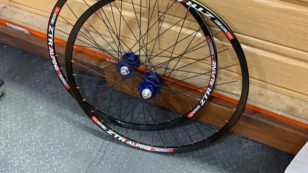

Not easy to find but my new built a NOS 2006 Element has been built with a 2018-2019 Reba, rock shox still made good 26" forks and for wheels ... custom made CK and alpine rims, the wheel set was a problem. Not easy to find a Easton or Mavic top range in 26" only Cross ride in mavic. The other componets are compatible. The handlebars are still made in 600mm (Ritchey superlogic). Even the rear shox is from 2018-2019 fox.
This bicycle is amazing how it works and feels. For me it is perfect.
