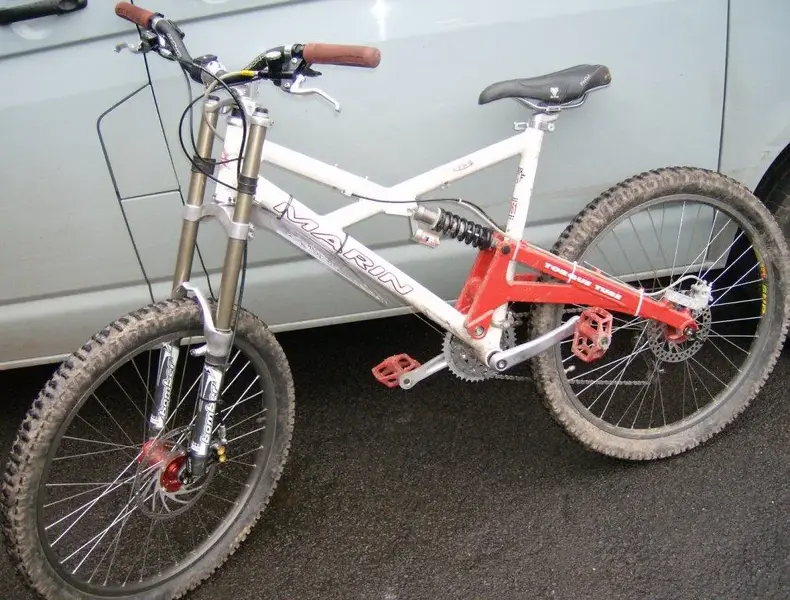

Marin B-17
The Marin B-17 (with a few tweaks!) can still hold it's own against most of the current 'Freeride' bikes.
I ride this bike on trails and downhills and it will still ride back up while the big travel boys are busy pushing.
With 6" of plush rear travel, if you were lucky enough to get the very early spec'd Fox Vanilla RX instead of the rubbish Shock Works later rear shock.
The original RST Hi-5's were shocking (or not as the case may be) and ran on elastomers with air damping, you had to be 15+ stone to get them to move. If you replaced with something better it made a huge difference.
The main problem that I could see with the FSR design was the lack of seat post adjustment. If you ran a longer XC style seat post you couldn't put the seat right down for hairy downhills and jumping as the post hit your rear shock!
This was never a problem with the Marins.
The B-17 ran a beefier, longer rear swing arm increasing the wheelbase over the XC versions and improving high speed stability.
This bike was a revelation to me, as here was finally a bike that had some proper suspension travel for taking the big hits, not just 3-4" for the XC boys. It cost £1280 in '97 (or maybe '96, I've got the receipt somewhere).
It will take everything I can throw at it, especially with 170mm travel Jnr T's, but still manage a days XC riding (unlike me!)
But roll on the downhills....
B17
The only fault I had with this design was the tendancy (with the seat up in normal XC height) for them to "bronco" over multiple bumps and throw you over the bars, the rear would be recovering as the fork compressed, increasing rear shock rebound helped, but then the rear tended to pack down over mulitple bumps. I notice you have the front very high and the seat low!
