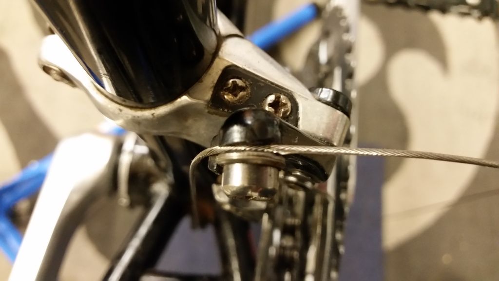

Hi all
Just changing cables and it's been a while .....
Is the cable routed correctly?
XT m735 bottom pull
Thanks!
That arrangement will work, as the pull angle is the same, but re-route the cable so it touches the pinch bolt. so it's wedged between the bolt and the mechs' aperture.....
