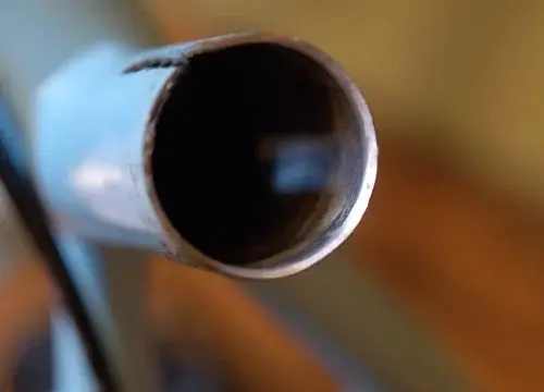

I did it because although the seatpost size was intended to be 27.0mm, the seatpost was loose enough to drop down under its own weight as soon as the clamp was released - which in my book is too loose.
The Coke can works well for shim material as it is soft enough to form a lip at the top - steel shim stock would probably crack if you attempted this.
Brass shim stock would probably be ideal - and if it is to be bonded you can do without the lip anyway.
