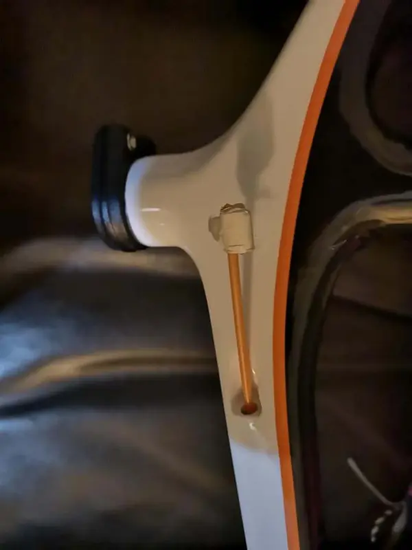

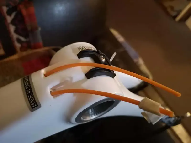

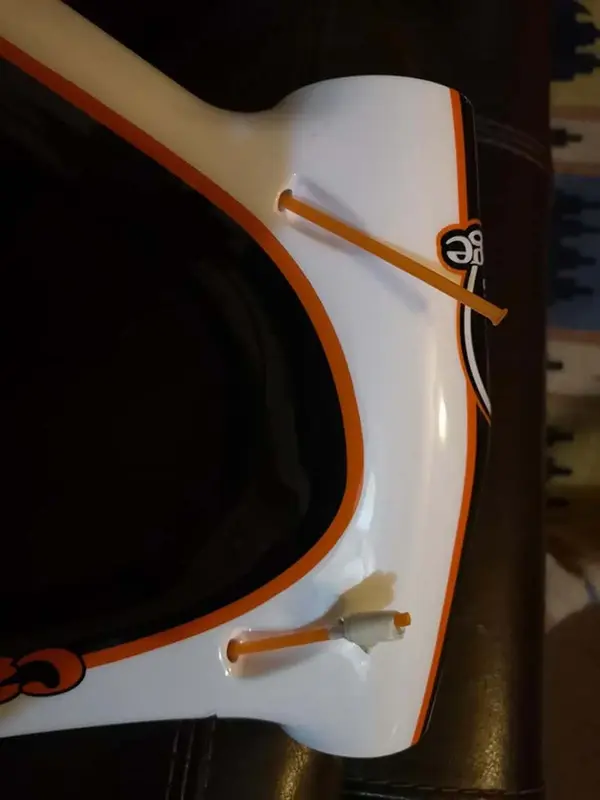

My carbon road bike frame arrived today. Cabling is internal. All new to me.
Am I right in thinking the tubing shown in the pics is to thread the cable through, after which you pull the tubing out? Then keep it for next time, threading it through on the old old cable before removing that cable & threading a new one through?
Or is it an internal lining that stays in place to protect frame from cable & is trimmed to fit when the short sections of external outer are fitted?

If it were me, I'd thread the inner cable through the orange sheath, then trim it rather than remove it. It will stop your cable cutting through the carbon, and depending on the outer cable, will help keep it sealed. I'd still put some heli tape or protective patches on the frame to protect from cable rub.
Thanks for the advice. I was leaning towards that method after having a good look at it. As well as rubbing within the top & down tube, I'm particularly concerned by bare cable rubbing on the exit holes by the BB cable guide as they exit the down-tube & where the FD cable enters the seat tube.
So if left in probably an idea to get some longer tubing to push over the old cable at replacement time to guide in the new cable, then remove & slide the old trimmed tubes back on (or replace if worn, of course).
Aye - any area where rub is a possibility will be protected.
Cheers!

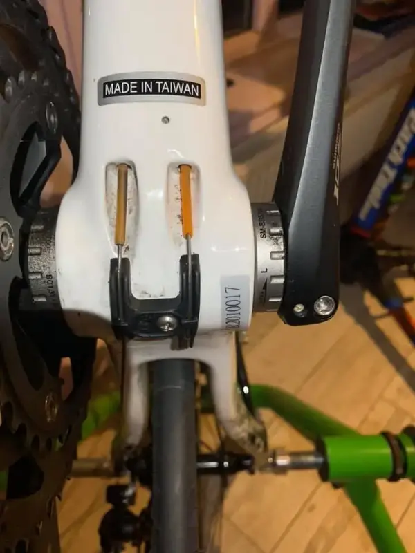

Method confirmed. As they come as new. An owner kindly posted a pic elsewhere.

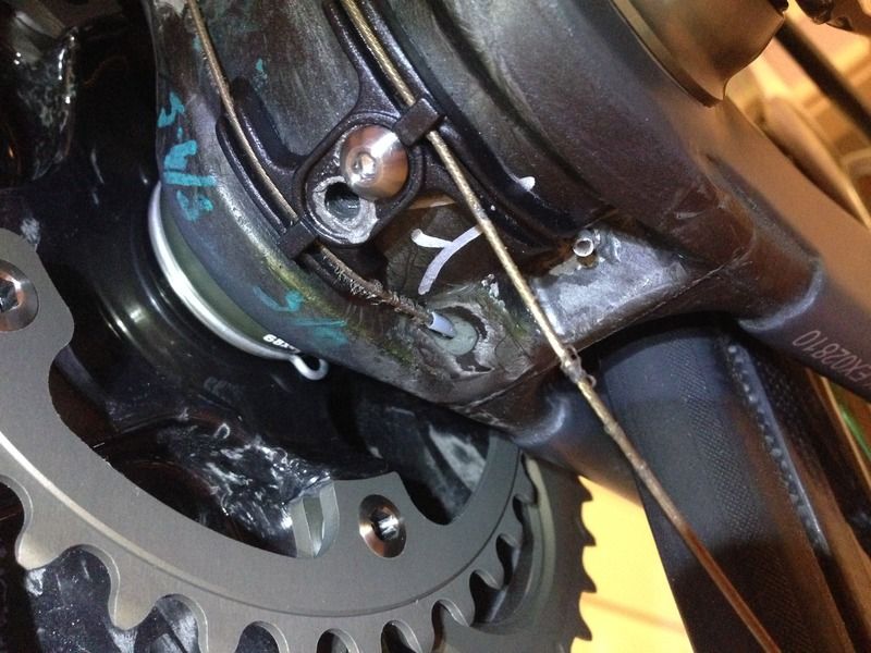

That's exactly as my tri bike is done externally:
And internally (under the bottom bracket shield) :
Ignore the loverly shedding cables, that's the reason the photo was taken ...
