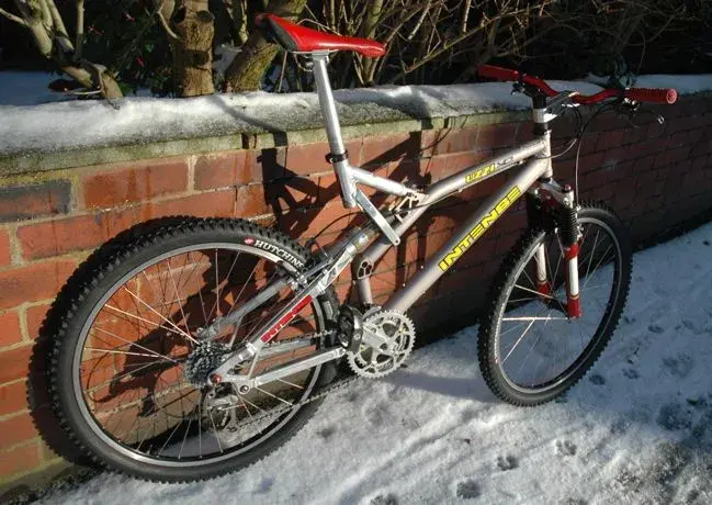

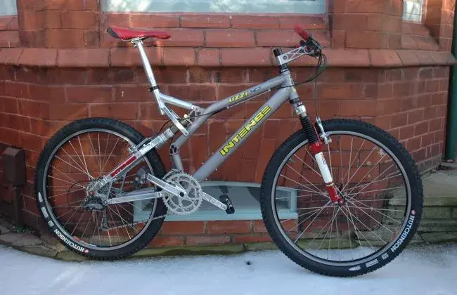

First build of the Uzzi - much tweaking and sorting to be done yet. Aiming for a 'tough' XC specification... NOS DHs; L&Ms; Syncros hubs/wheels and Pauls complement the unbelievably milled-to-within-an-inch-of-its-life frame!
Mr K

It's good to scan Ebay for spare Intense FSR parts.. I think there were some Uzzi parts a month or so back..
Got a coupla updated photos of my Uzzi..
