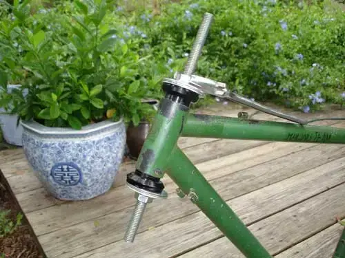

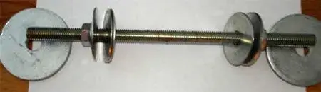

I've got a long piece of threaded rod (£1.49 from B&Q), with a piece of wood....bit like this....
