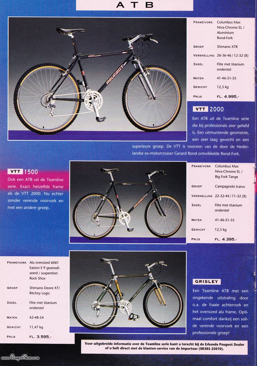

Loving that team line 2000 LGF, very, very nice

Nice Grisley. Slightly different decals to mine. Some specs for the TL800. TL1000 at bottom of next, and one that looks like your graphics at the bottom of the last.
main.php
Spec from memory...
Rock shox mag 21 1 1/8th
Ritchey Logic headset 1 1/8th
Ritchey Force stem
Ritchey pro lite bars
XT thumbshifters
Ritchey logic brake levers
Ritchey WCS grips
Ritchey seat post
Selle italia flite
Ritchey cantilever brakes
XT front mech 34.9 bottom pull
XT rear mech short cage
XT bottom bracket
Ritchey chainset
XT Pedals
Ritchey Megabyte tyres
XT chain and cassette
