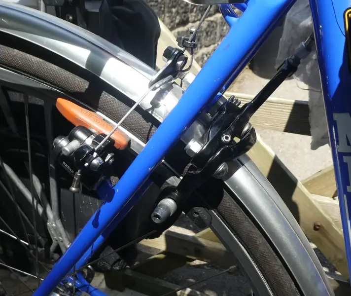

Can you post a picture of your drag brake setup please half cog?

Attached photo shows our tandem back brake set up.We are around 20 stone all up and the bike weighs around 44 pounds plus tools clothing and spares.I reckon we can hold the bike to a steady speed down to around 1 in 10 by just using the drag brake alone. I only use it when the ground gets to about 1 in 7 then I apply the drag and use the cantis to feather the speed.Whilst you will slightly increase rim wear you may find you only use it for a few seconds in a ride so nothing to worry about. Its not advised for long alpine type decents as you would overheat the tyres but it sounds like you are not doing that anyway.Much below 1 in 7 and the bike becomes in danger of running away without the drag. Modern tandems use a disc as a drag but ours is around the 127mm mark and hes been cold set before we got it so discs are out. If you go this way then make sure whoever does the braze on brake stops on the top tube realises what you are doing.Turning the brake around swaps the cable feedin side so stops need to be on the other side of the tube.Ours runs a dual pivot diacomp and they feed in from the other side anyway. If you do it then before commiting to some near vertical decent run some smaller ones first to get a feel of what happens. Looking at the front fork I think you can forget v brakes.You wont have enough clearance for them to work. I did try them on the tandem but it was a non starter
