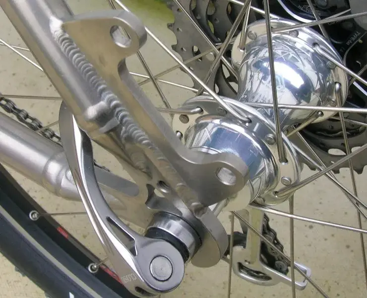

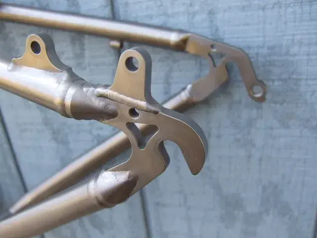

This is an interesting example for all you Kona experts. Not only Disc Mounts added, but also with an extra cable stop on the non-drive side Seat Stay. Despite the seller’s explanation for the Dog Collar, I assume the real reason is to neatly run a cable rear disc.
I may be corrected, but I’m guessing early ’97.

something's wrong about that frame :? the 97 versions of HeiHei had no disc tabs welded, as well as that single stop - so seems to be welded on at a later date by unknown source. Anything else would be new to me.
I believe that the Disc Mount was available as a retrofit modification done by Ti Sports. The e-Bay example is similar to the version fitted as standard to the Score.
My retrofit Disc Mount on my ’97 is somewhat different – however I do not have the extra cable stop on the Seat Stay.
